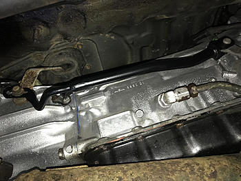

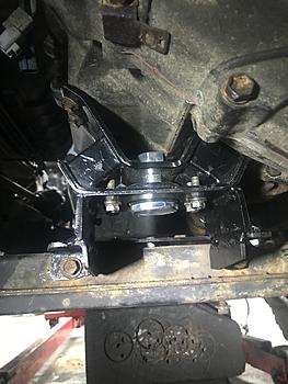

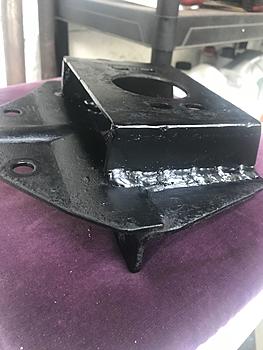

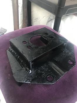

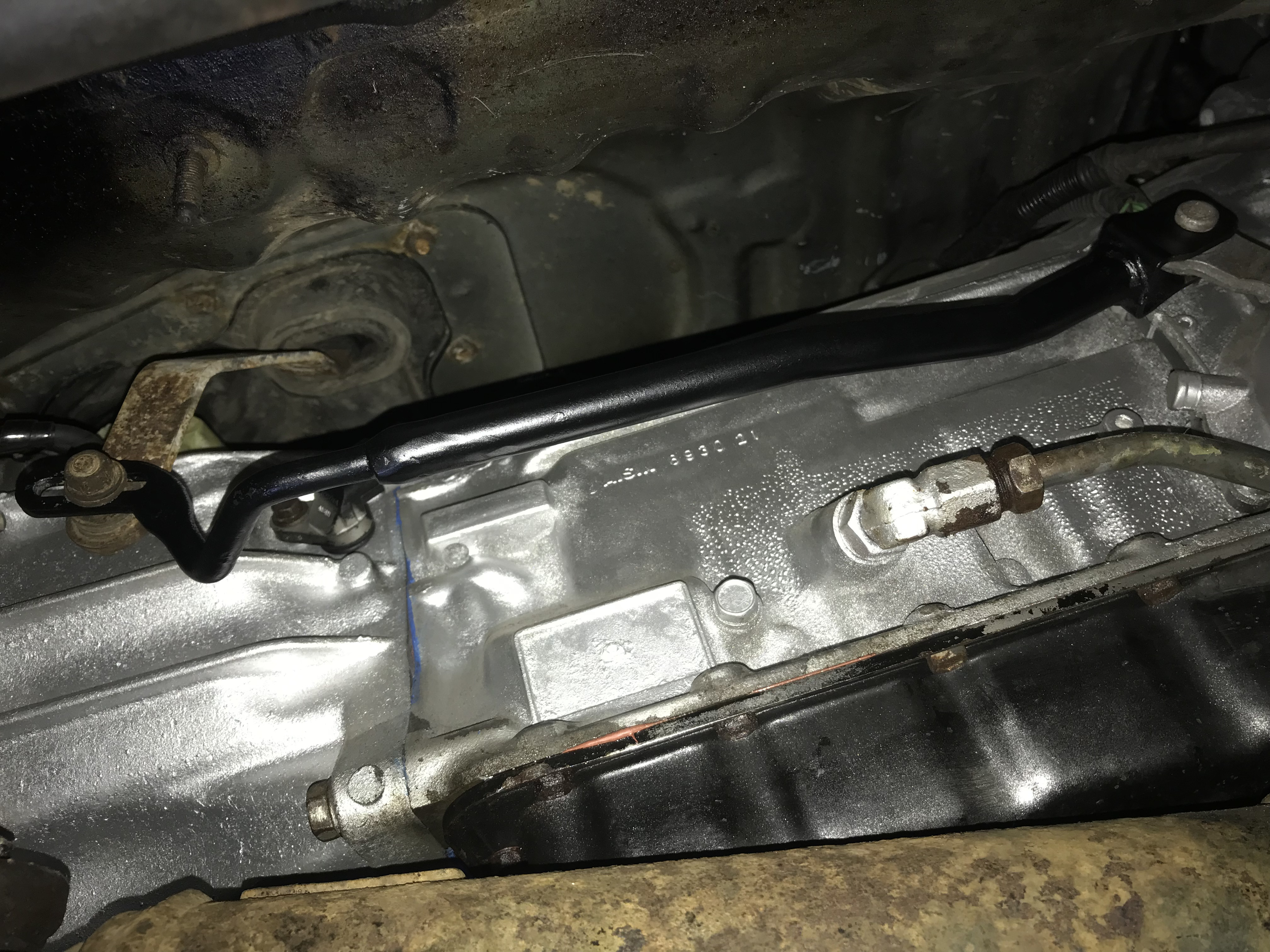

Gearbox mount fabricated and installed

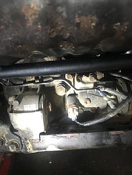

Does anyone have any info on how to wire the transfer case? I think I've got all the engine and gearbox wiring figured out, but I think there's 5 plugs on the transfer case that somehow need to be connected to something. It's a shame a lot of Vince's posts have gone now, as I'm sure the answer would have been in there somewhere.

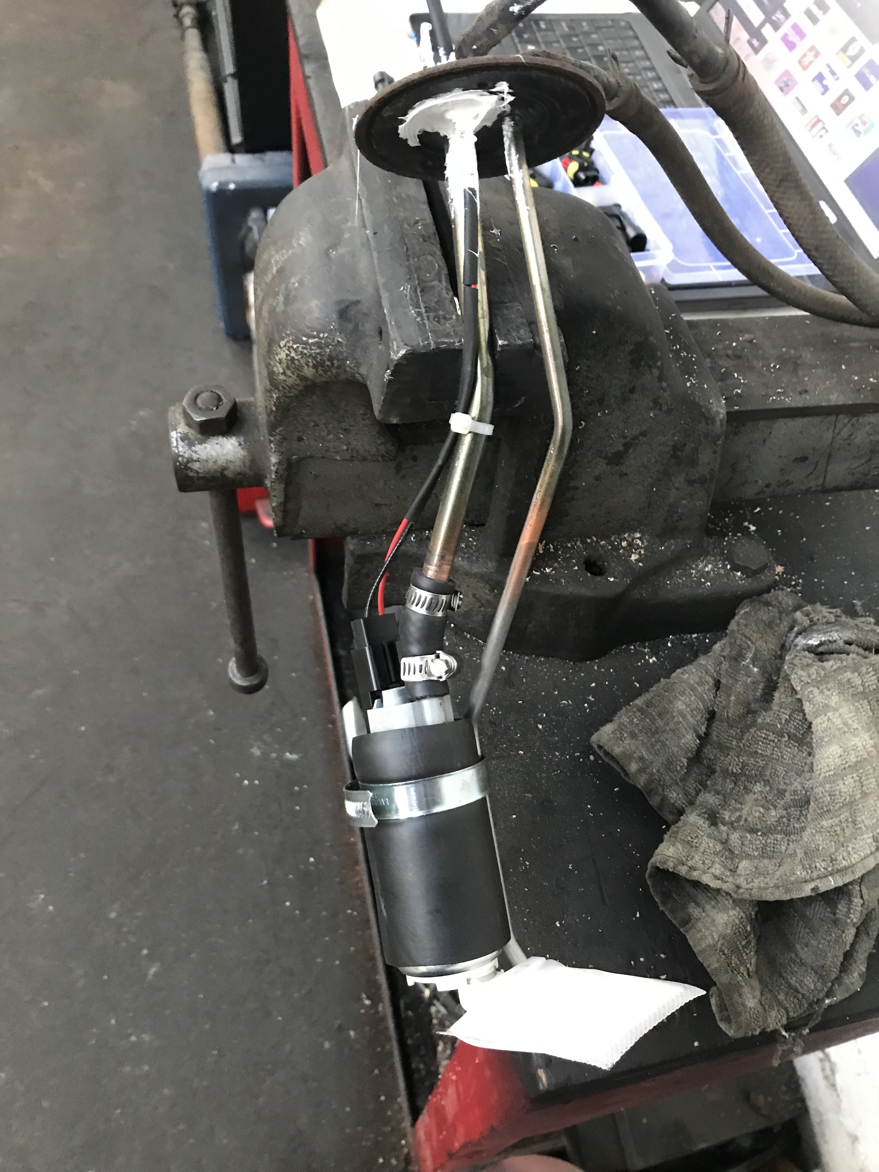

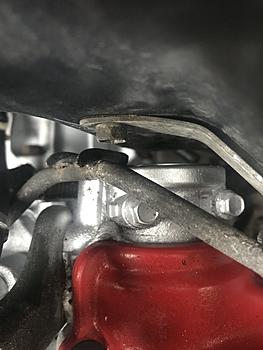

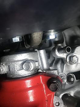

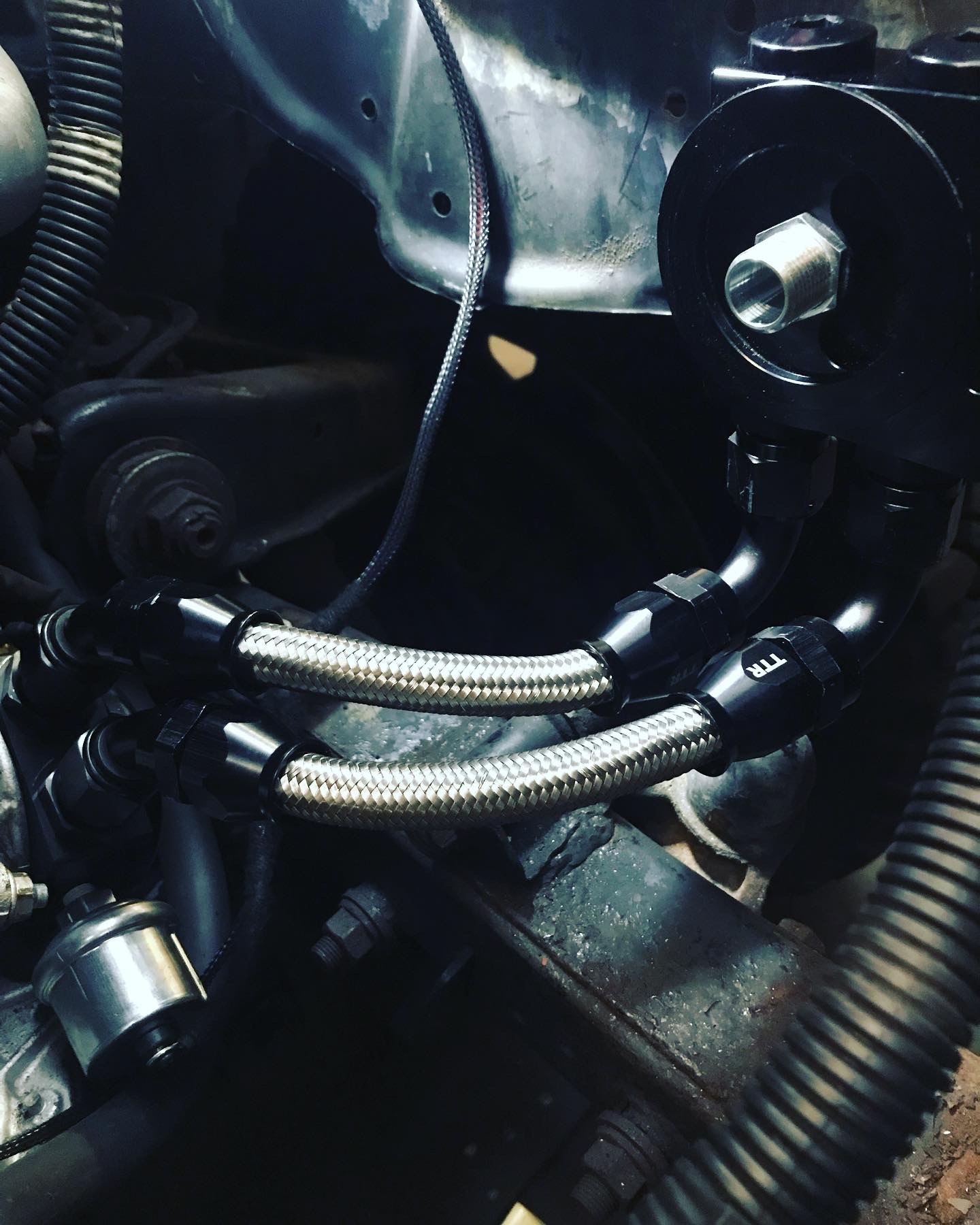

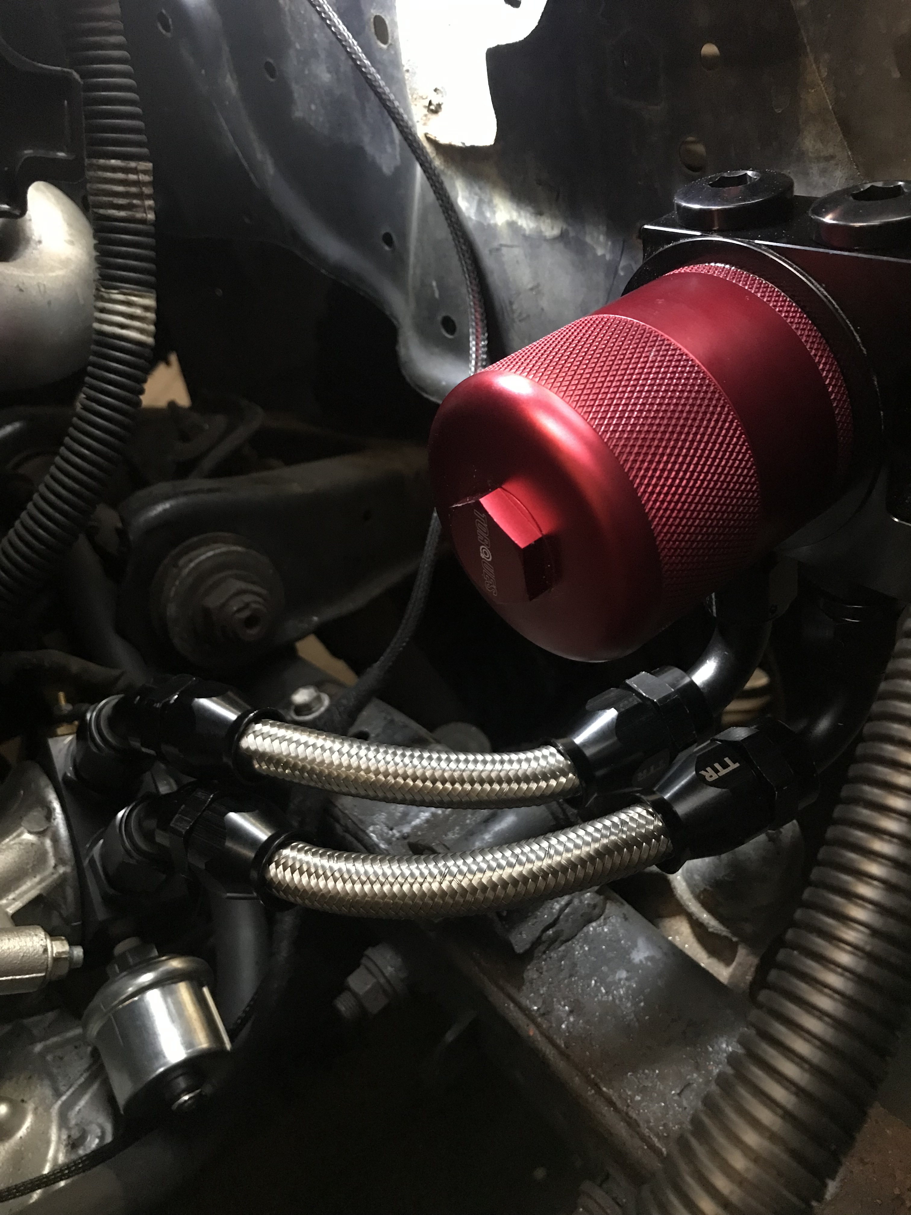

Well it’s been a tough slog. Engine is in its final resting place, Walbro fuel pump is in the tank and refitted along with new fuel filter and AN-6 fittings. Oil relocation is fitted with new oil pressure and temp sensors. Loom is all fitted and shoved through the firewall. Gear linkage shortened and props refitted.
Now we come to the wiring. I desperately need some advice from either Vince or someone who may be able to help actually wiring everything to the surf. I bought the diagrams etc from Kelvin at cartune.nz, but there’s a lot of stuff in there I don’t understand. Like the alternator wiring….which seemed to just plug in using the surf connections. And the ecu, which as I am lead to believe needs relays and fuses for the fuel pump, starter and efi circuits.

do you have a link for that oil filter plate? im looking for something like that before i supercharge it.Originally posted by DMAudio View PostWell it’s been a tough slog. Engine is in its final resting place, Walbro fuel pump is in the tank and refitted along with new fuel filter and AN-6 fittings. Oil relocation is fitted with new oil pressure and temp sensors. Loom is all fitted and shoved through the firewall. Gear linkage shortened and props refitted.

lastly, Kelvin @ cartune advised I need to power the trans. As I used the full loom from the Lexus, and the transfer box wiring just plugs in its original position under the dash, is there another feed I’m missing?
