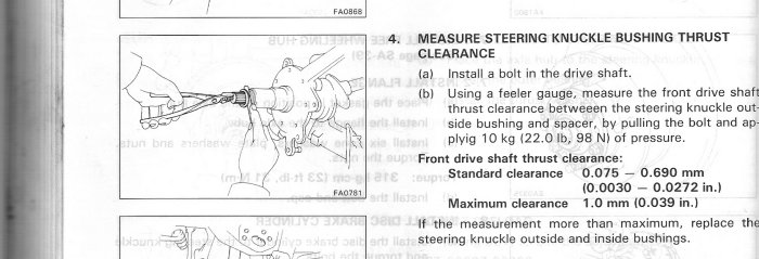

Just another quick question. Is this a Toyota dealer job to get these bushes? I don't see them on milners? Thanks again for the help.
