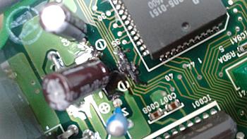

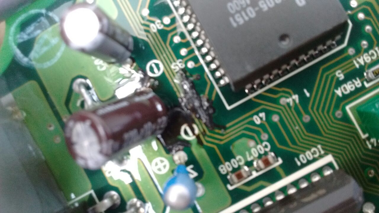

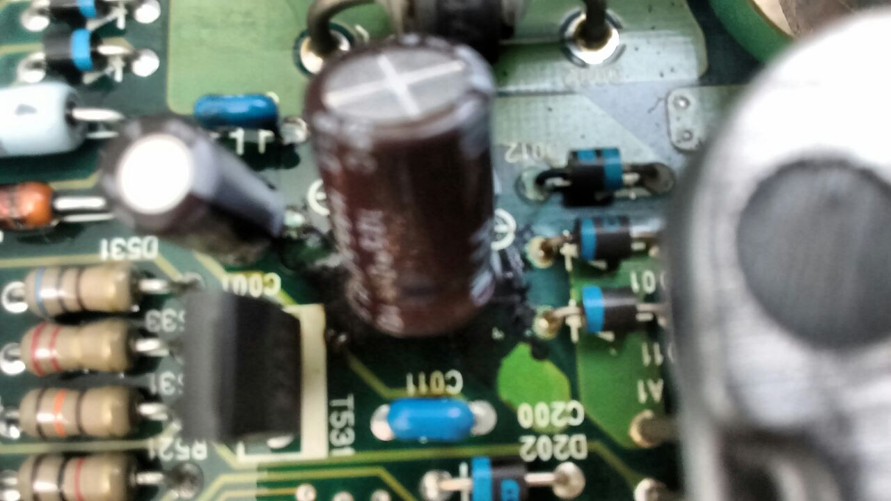

As per title, this has happened a couple of times in the past few weeks. Both times at low speed, sudden shutdown, no spluttering or anything, all lights come on the dash and you coast to a halt.
It then struggles to restart for a while. Engine turns over nicely but sounds as if no fuel getting to the pump. If you leave it ten mins or so it starts again and will run normally again for days. No engine light warning coming on. I have tried to pull the codes but all looks normal, light just flashes intermittently.
I have recently done a service, including new air filter and fuel filter. There is no misfiring, idles perfectly, no other sympoms.
I have found a number of threads on here but nothing conclusive, mostly the ECU is blamed, or the fuel pump relay.I will maybe open up the ECU and see if the caps all look ok. Where is the fuel pump relay?
Any ideas much appreciated, cheers.
