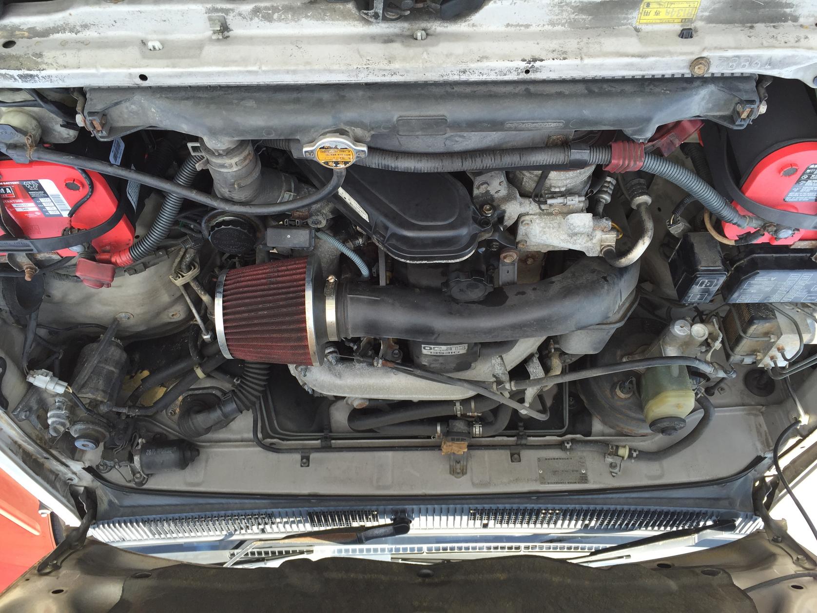

It's on the non exhaust side of the bay. Working on a heat shield and considering a hood intake. Works just fine in sweltering Okinawa summers even without an intercooler. This is how many performance cold air intakes are mounted on performance cars/trucks. Just redneck engineered.
How many of those performance engineering engines are twenty year old diesel engines?
it just seems that if you want to increase air to the engine then the source should at least be from a colder place.
In fact why not fab up a box to stick it in and have that feed from a outside of the engine bay.Eat.Sleep.Surf.Repeat.
I'm with snokenore.
Taking out an OE cold air feed and putting in an aftermarket hot air feed is a good way to restrict your engines ability to produce power.
Its one of the first things people do to make the car a little bit less drivable.
Win win win.
Seriously, people put intercoolers on these things for a reason. The colder the better. best would be to mount a large cone filter inside the righthand wing with a very short pipe run to the left of the aircon pump but unless you relocate your battery its a no go.
The OE set up with that pipe over the whole engine is a bit daft imho. Its not like its a cold air feed anyway. I have a temp sensor in the filter housing and one after the turbo and intercooler.... Filter temps are always 7-10c higher than ambient and post turbo temps are about 7- 10c higher again.
In engine bay open filters on these engines are about as much use as a chocolate bicycle in my opinion. You would be sucking in very hot air (40c) and then passing it through a very hot turbo
so you could be seeing preignition charge temps of over 60c if you dont have an intercooler.....ouch
