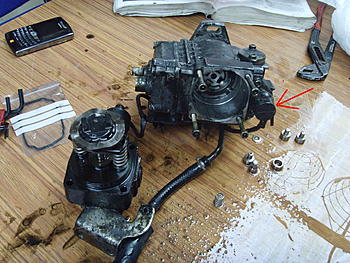

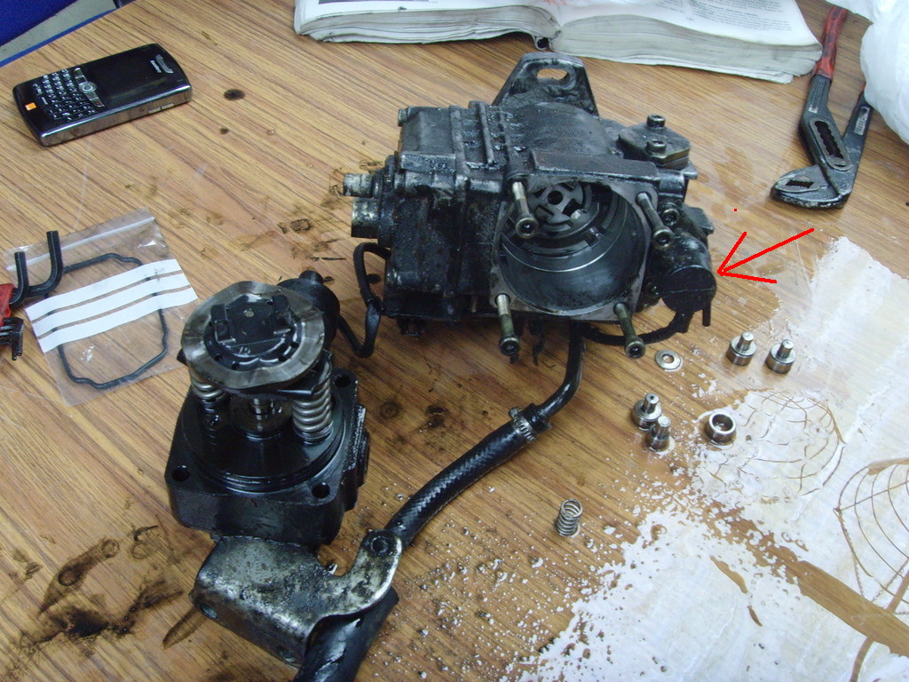

    Fit new seals (leaking from the same place as the pic below i think(courtesy of Coolsv650 pic))

    Was this after running veg? looks like the stop sol or what ever they call it, mine did it after running on veg two surfs ago. Never took the pump off mine just changed the Denso sol and it was fine (£70) think i payed.
      Is the leak where the arrow is pointing on the colour photograph? If so, that is the Timing Control Valve and it only has a gasket at the attachment end. That valve can be removed and replaced without removing the pump.
        Thanks for the replies Folks and aye it seems to be from there just spoke to a Denso specialist up here and he can replace the seals for me for....waiting on quote but hopefully wont break the bank.... was thinking though, all the rest seemed to be fine until i repaired the top one then the other one went from the pressure change i guess so might just have to dig deep for this one. just one last question please if it was from the end is it easy to change in situ?
