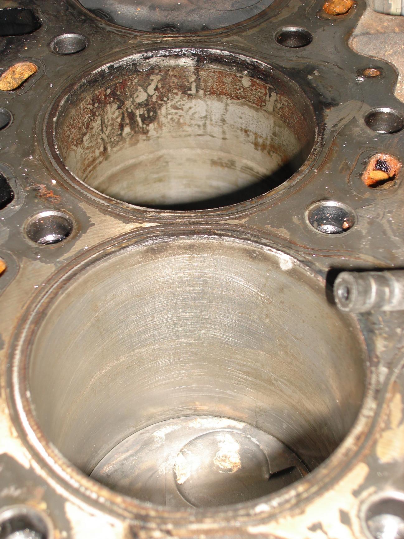

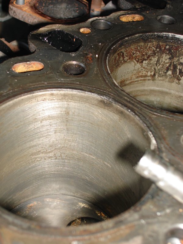

    Took the head off my 3.0 today ready to fit my shiny new one tomorrow..

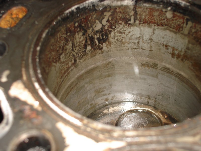

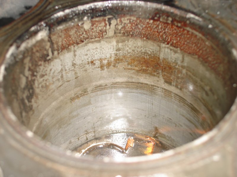

    It's been sitting for a while and seems the no.2 and 3 cylinders have got some corrosion in them. Most is surface rust but there is a pit that would seem to match the piston rings going around both bores about 3" from the top of the cylinder.
    Is it possible to hone the cylinder, fit new rings and be ok or do I need to look for a new block ?

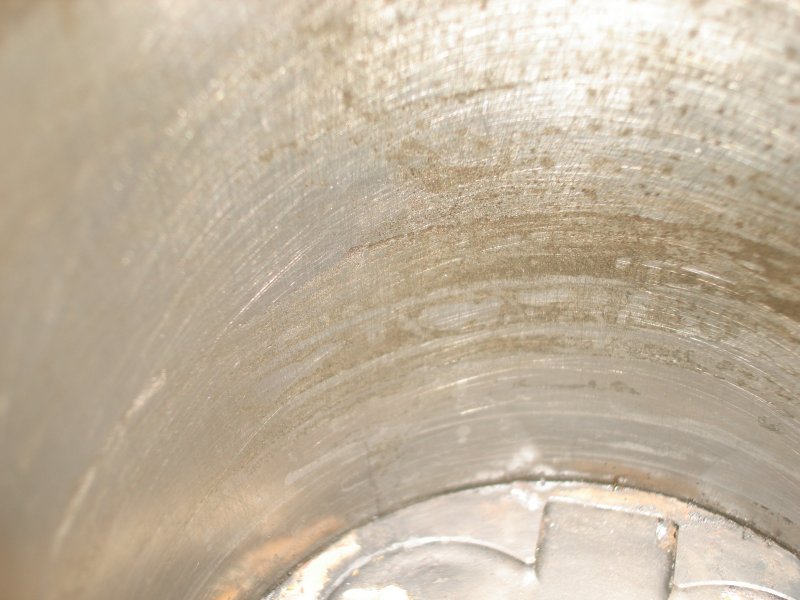

    In the pics I've given one a sand over to remove all the surface grot, the other is as found.

      Technically its not good, but if you don't mind taking the head off again later, for the price of a head gasket and bolts I'd be tempted to see how it runs before going to all the trouble of a rebuilt/used short block.
        I'm kind of with Tony on this one. If that were a customer's truck; I'd rebuild or replace the bottom end. On my own truck; I'd see how it goes with the new head.
          Thanks both of you for the input . Think I'll spend the evenings this week swapping all the bits over to the new head and have a long think about what to do.
          Rob.
