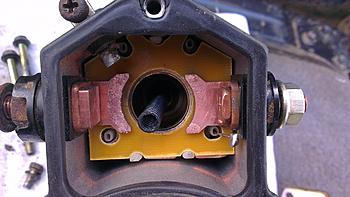

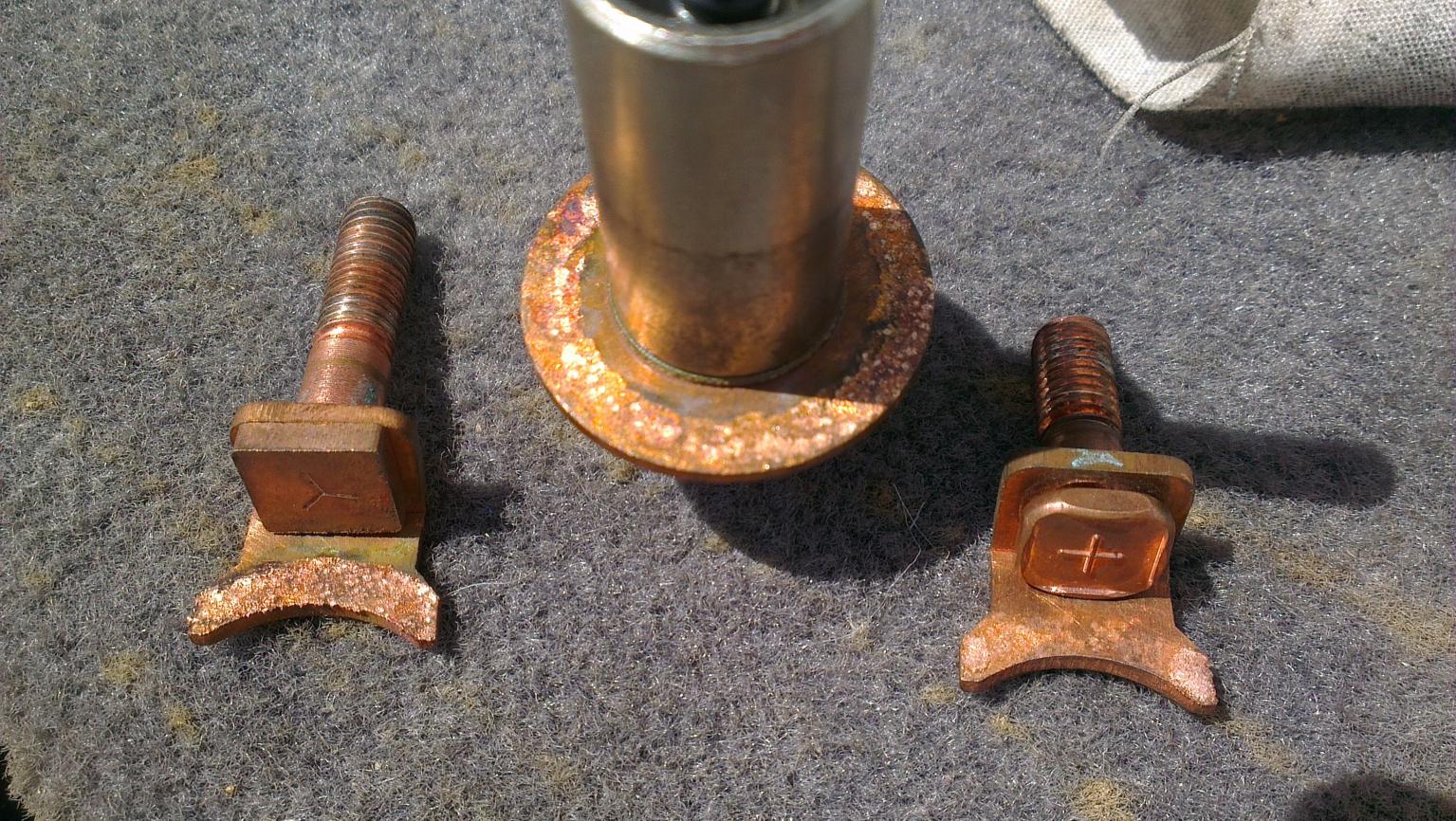

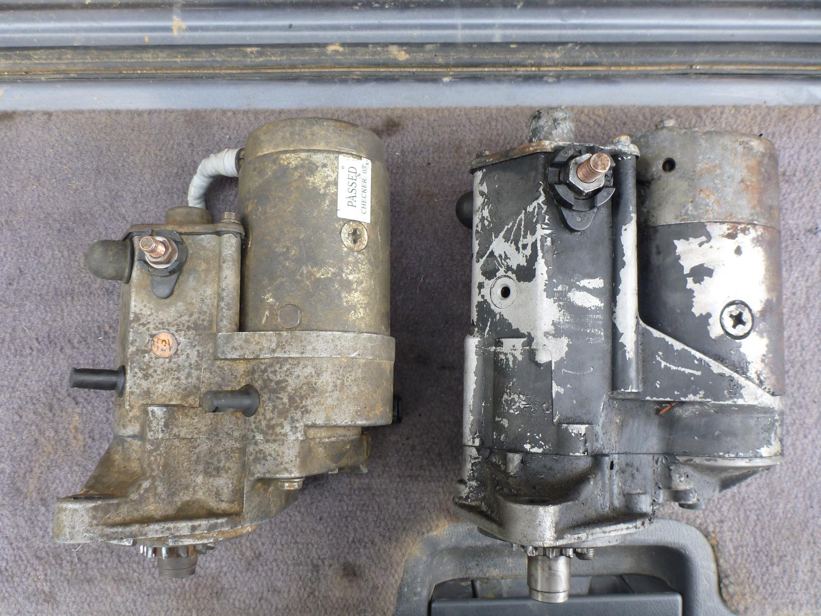

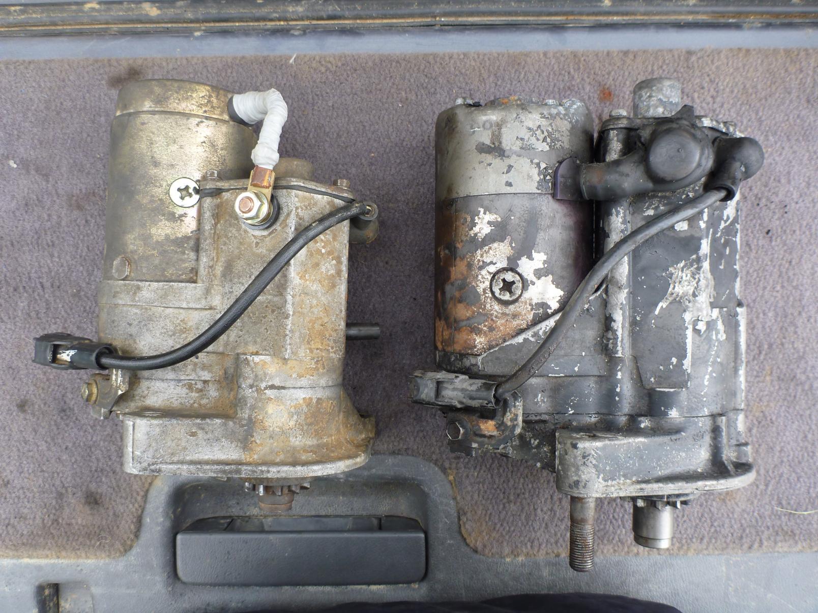

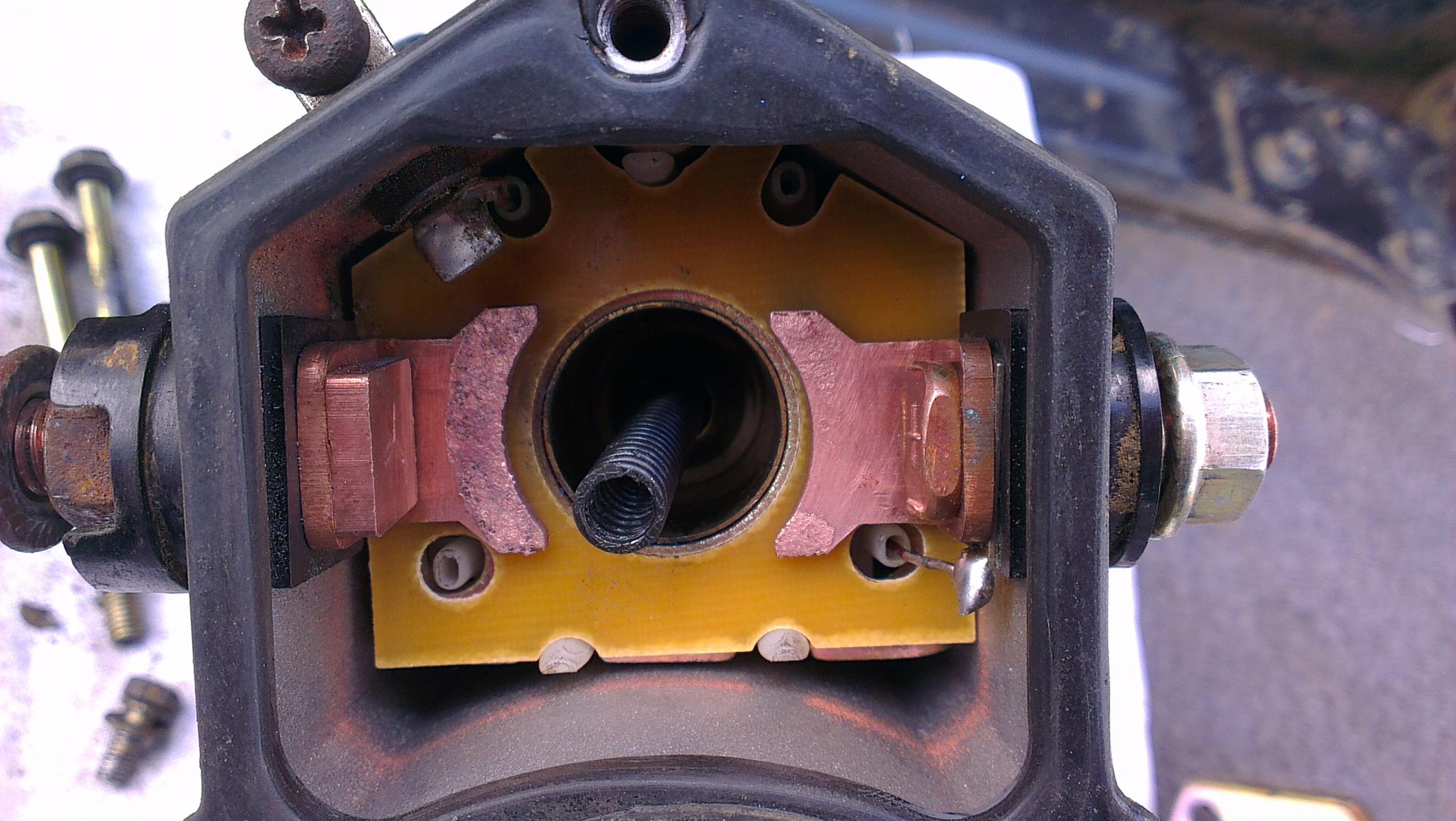

I bought a 1995 KZN130 3.0 lt Diesel Surf back in March and new at the time it wasn't running properly but thought I'd have a go at getting it going again. When I first got it, it started and ran but would cut out after 10 mins or so. I've tinkered a little when I've had the time but now it won't start at all.
Even with freshlly charged batteries it struggles to turn over, I've taen the starter off and everything looks fine there. My next thought was a siezed accessory so I removed aircon and alterator belts and tried again. Still no better so not an accessory problem.
