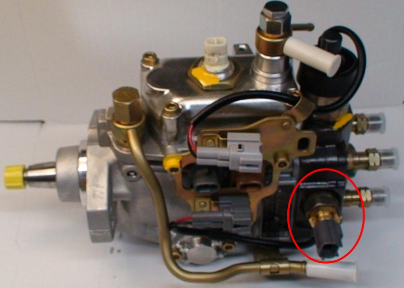

              Is it the one behind this little bugger:
              http://www.hiluxsurf.co.uk/showpost....7&postcount=16
                Well I got the little filter out behind the sensor circled HERE and gave it a clean, although there wasn't much to clean, just a small amount of debris. More like a cylinder that a witches hat though... is that the right one?
                Put it back together and still have the same problem; lack of power, check light coming on and max revs of about 2500 ish.
