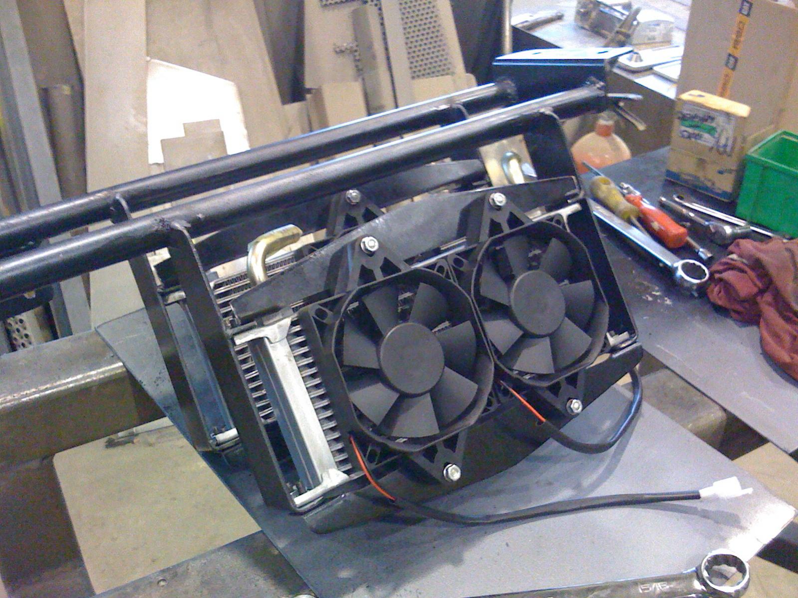

        im in 30 degree heat with mine - i put small atv fans on my oil coolers to help in traffic, they would help a fully laden truck keep the atf temps stable. i tried mine in traffic and they drop the atf and oil temps by 10 degrees fairly quickly.
        i have them manually switched and only use them if i see the temps soar in long traffic jams.
        they were only a tenner each on e-bay. theres more pics on the lexurf v thread that may give you some ideas
