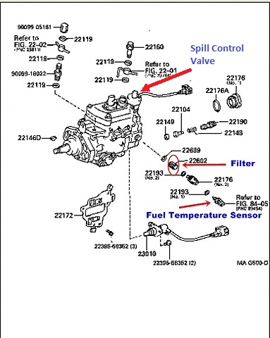

    this sounds like a way forward - where are the fuel sensor & spill valve filters and are they replaceable or is it a case of taking them off and cleanng with parrafin etc.

      The fuel temp sensor is on the side of the very rear part of the pump, the spill control valve is on the top of it, the filters are cleanable, just small wire gauze filters. You can do them with the pump in place but moving a few wires and hoses, but be careful not to lose the wavey shaped washer behind the fuel temp on when you take it out.
      When each one is removed you can pump the primer and check fuel comes out the holes
      Also, I'm assuming the timing belt marks have been checked, especially the bewteen the crank and fuel pump, which is driven internally with gears. Also the fuel filter changed and fuel lines back to the tank blown through?

        Just so I'm really clear on this, the fuel temp sensor is just that, a sensor, with a connector going to it - do i just remove the connector and unbolt it, and I assume the filter is on the end
        same with the spill control valve, although it's on the top of the pump, is it the same method of removal??

          The fuel temp sensor has the filter behind it, and is easy to get out with a 22mm spanner, the spill control valve is a little trickier as its a big hex on the bottom, I altered a spanner to make it fit and its often really tight.

            pic of spanner to get SCV out.
            http://www.hiluxsurf.co.uk/showthrea...+valve+spanner
            pics of the filter behind the temp sensor..
            http://www.hiluxsurf.co.uk/showthrea...r+gauze+filter
            Pump pic.....

                following Tony's instructions I removed first the spill valve (just managed to get a claw foot wrench on it) and the filter was completely blocked up with gunk.
                cleaned it out in unleaded with a soft kitchen brush (don't tell the wife) then on to the fuel temp sensor - this was a lot easier to get out but the filter took some hooking out of the hole (praise be to MAC pick sets). Again, almost totally clogged. Cleaned this one as well so clear & shiny.
                All back together by just after 5pm and took her for a blast - got a bit scared when she cranked but wouldn't catch but as soon as the pump re-filled off we went - BLIMEY !!!!!!! TALK ABOUT GET UP & GO !!!!!
                She feels totally different, loads of power and no loss of power on gradient or any smoke at all - in fact I think she's performing better then she ever did and I've had her 6 years.
