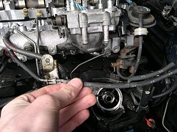

            Thanks for the help so far! I thought i'd get a few more pics to help me out as I have been a bit vague so far.....
            In pic no.1

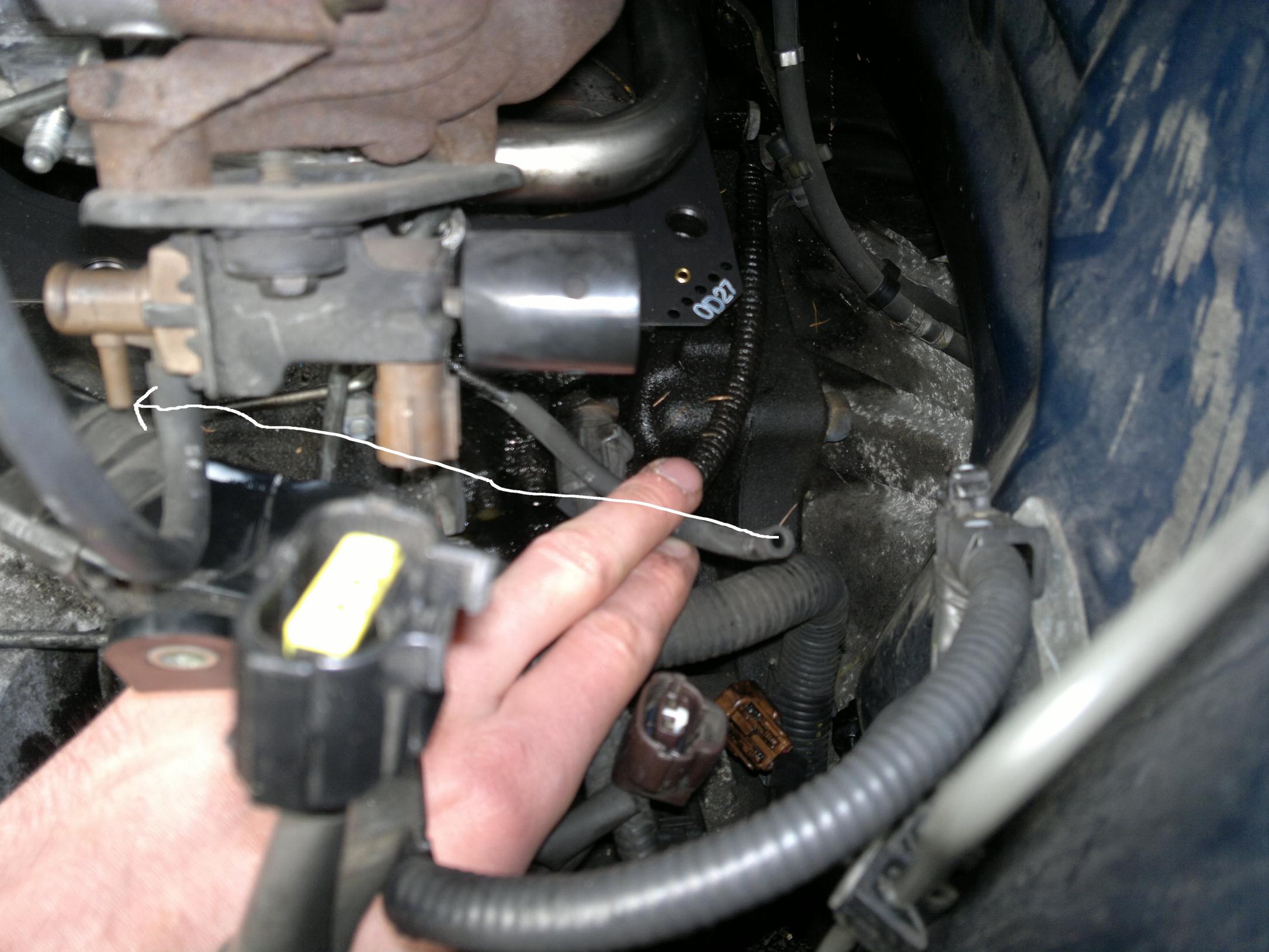

            this is the pipe I have been asking about, am I right in saying the hose in pic no2 connects to this? i forgot to add this onto the new head so i think thats where I went wrong, but the prob is it's VERY close to the block, will the head not sit properly then? it just seems like if I add this hose the head will crush it or it will be bent to try keep it clear of the head?

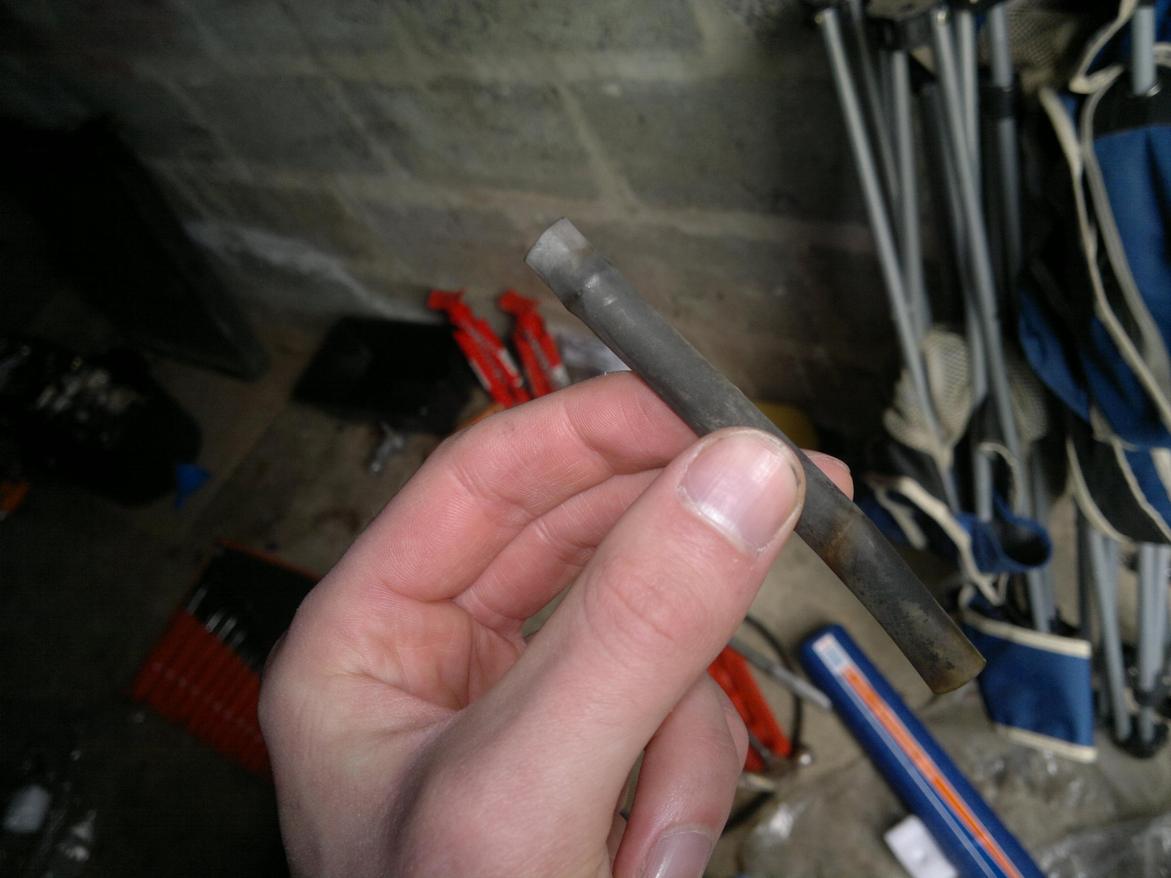

            I think/hope pic no3 is correct also?

              If memory serves me correctly, the pipe in No.2 is the one you need to connect to the pipe in No.1. You need to straighten the end of the pipe in No.1 as it is bent up too much but don't worry, the head will sit square and straight. The pipe is designed to run alongside the block, just below the head line.

                so it looks like i bent it up when pulling the old head off! I will bend it back and refit pipe, that should get me back on track finally!! lol

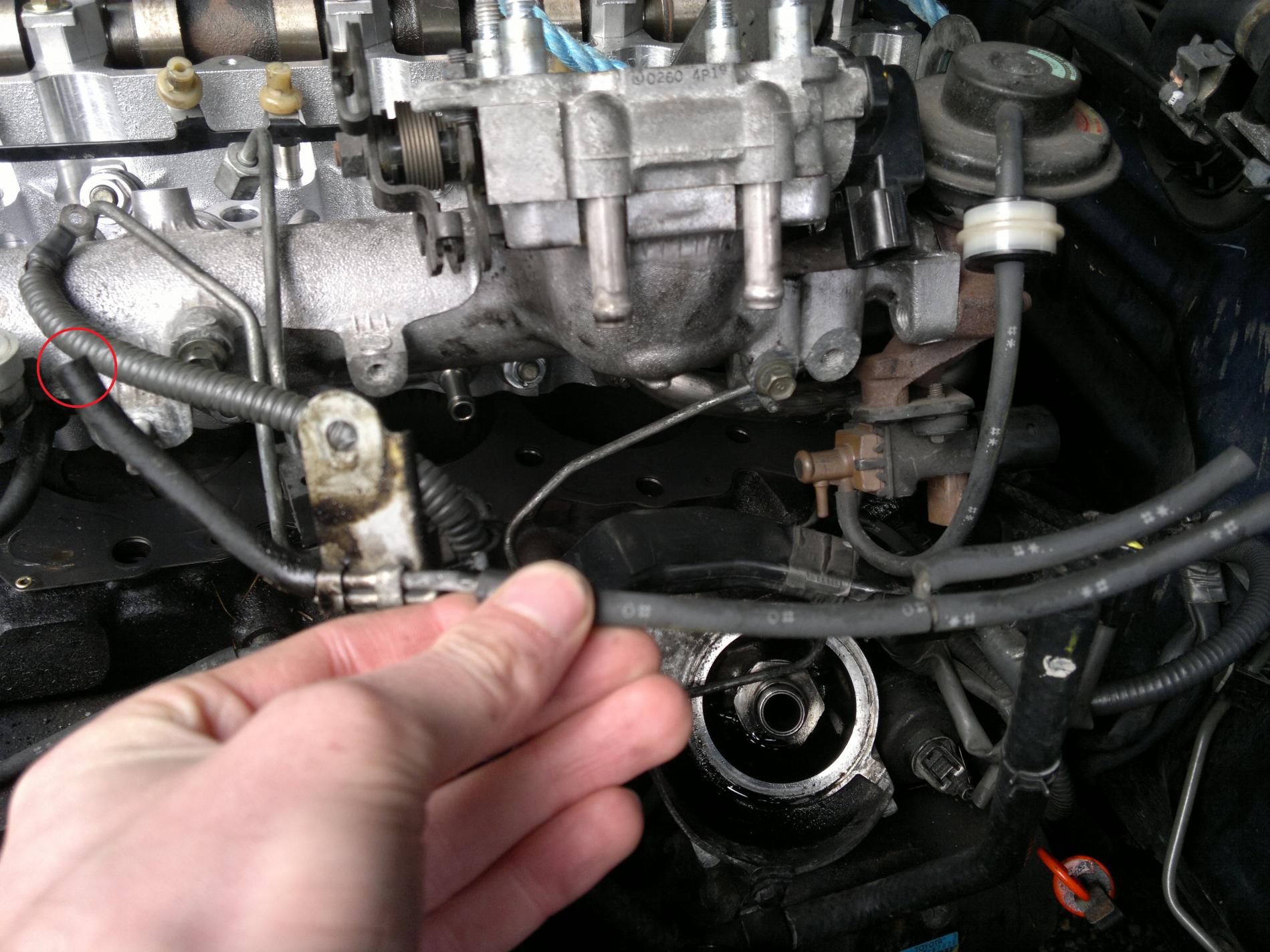

                      thats EXACTLY what I am looking for!! thanks very much again Hazzo, what was also confusing me was the end of the pipe sat over the block a little, I'd obviously bent it when taking it off!!
                      any idea what this pipe/cover is for?
                        No mate, it just looks like a shorty vac pipe, connect what you have going by the diagrams and your sure to have one missing from somewhere, it'll be that one. These vac pipes did my head in and the branch on mine points to the head too, I bent it out slightly/gently before reconnecting. H

                          it is doing my head in! I bent it out no probs, but its trying to get it connected up and knowing the rubber hose wont move when I put the head back in place, as I have to move the whole head forward to get at it!
                            Connect to the branch end and tie a bit string on it to drag it to where the other end goes after bolting the head in position, I reckon kids build these as normal hands haven't a chance of fitting some of the gaps you have to work. H
