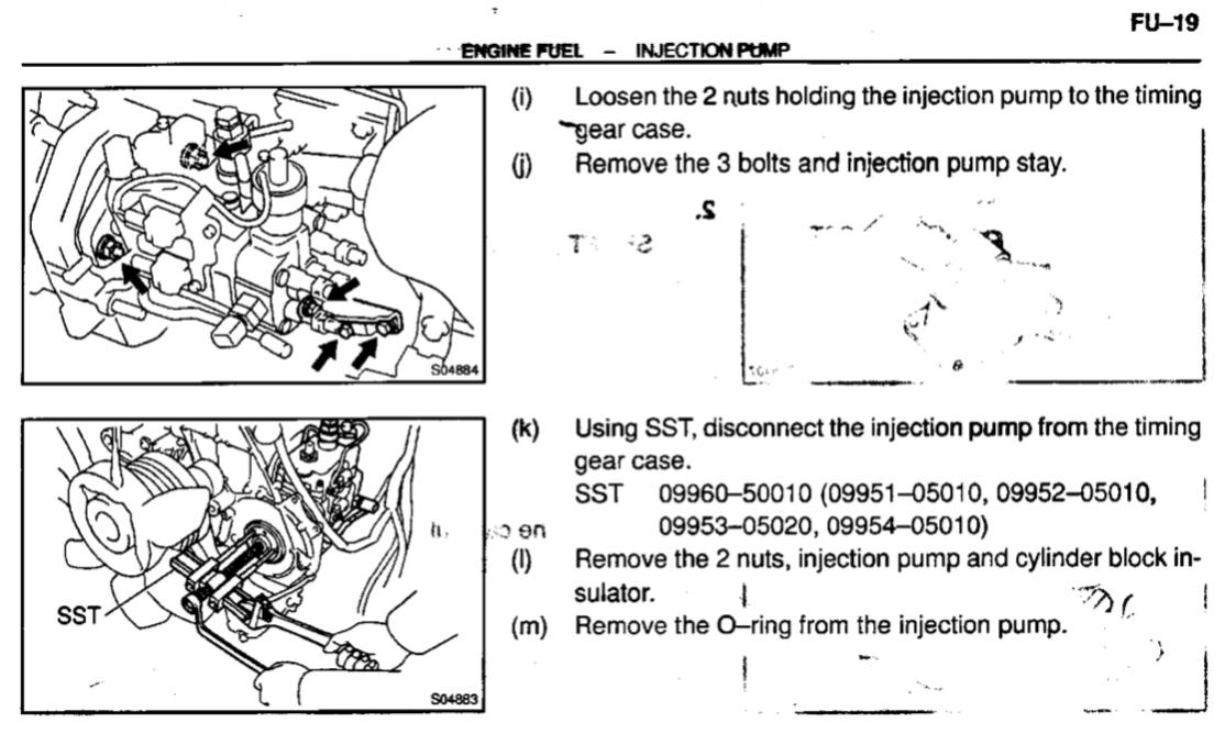

You will need a long bar to go on the threaded part and give the pump a good hard hit to release it as it is tight as a tight thing.
Make sure the small bracket on the rear of the pump has been taken off aswell or you will never get the pump off.Leave the nut on the thread and leave a couple of mm gap just so you can see the thread before hitting it
The 2 nuts in the top of the pic Kerr put up are 12mm.The one nearest the block is an awkward little shite as you can only turn it about 1/4 a turn at a timeLast edited by stormforce; 24 July 2010, 14:03.https://www.facebook.com/groups/henpals/
Job was pretty easy, I had stripped lots out to make access easier, thanks for the info guys.Originally posted by stormforce View PostYou will need a long bar to go on the threaded part and give the pump a good hard hit to release it as it is tight as a tight thing.
The 2 nuts in the top of the pic Kerr put up are 12mm.The one nearest the block is an awkward little shite as you can only turn it about 1/4 a turn at a timeAlan
