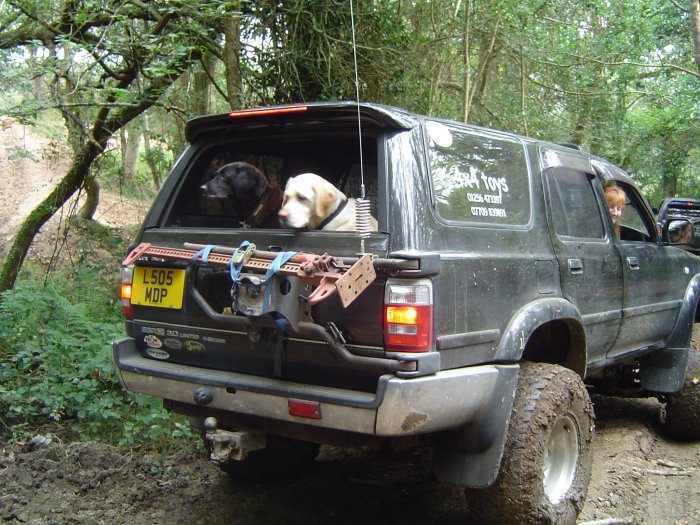

    With drop plate/ball on for towing.....
    Swapped with a Pin and Ball that won't drag on the ground when offroad (normally leave this on as it looks neater)....
