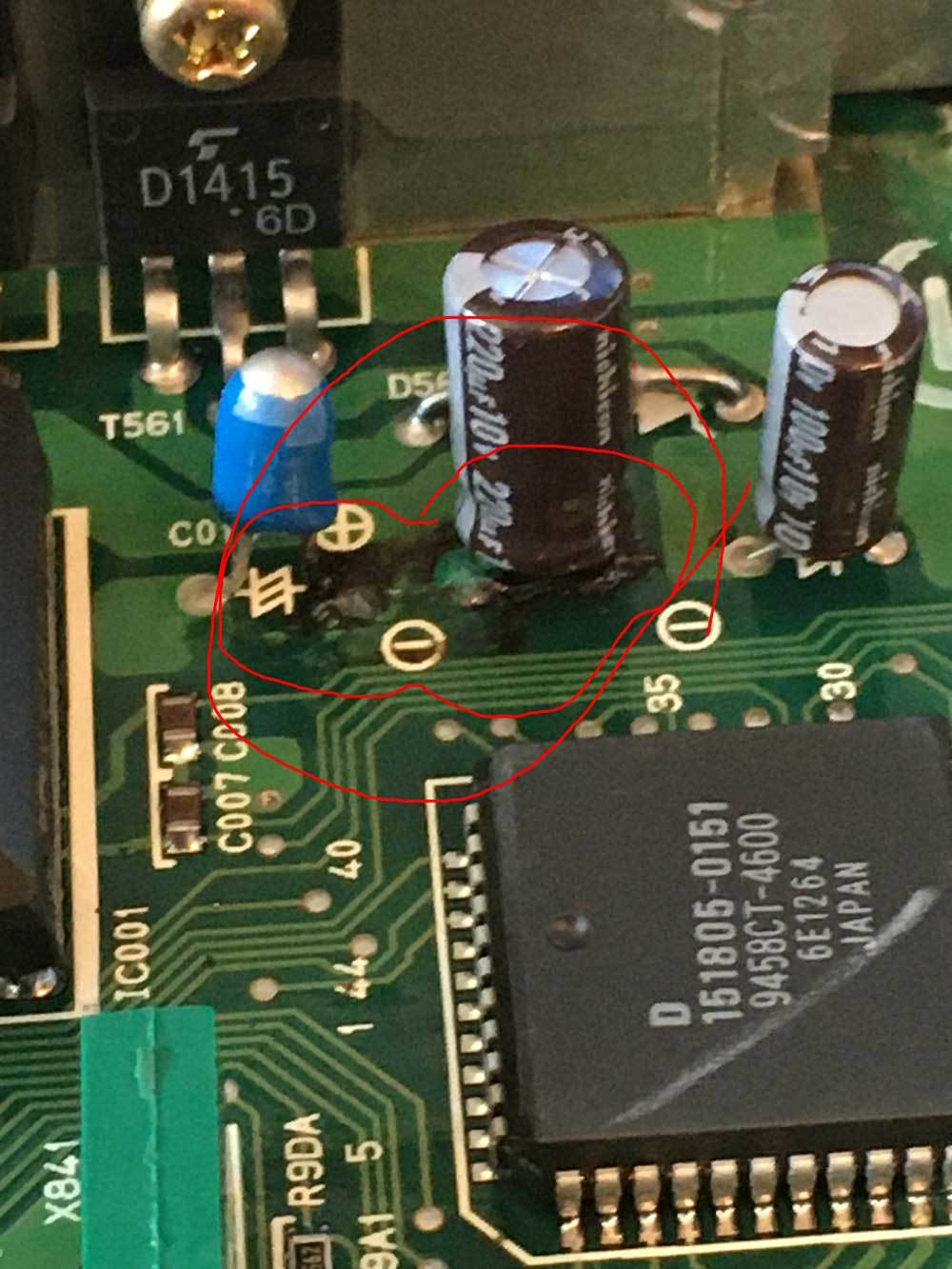

                  Thanks guys. I’ve since removed the ECU and a capacitor has leaked so I’ll be sending that off to a specialist. If this doesn’t solve it I’ll have to get someone to look at the immobiliser.
                    Thanks I’ll have a read. I’ve since removed the ECU and a capacitor has leaked some ooze out. I’m going to send this off and pray that this cures it
                      I know its an old post - but did you get the ECU mended, and did it cure the problem? Ive got intermittent stopping, and the fuel lines all look good - my ECU has a leaky cap (see image) - was yours same cap?Click image for larger version
