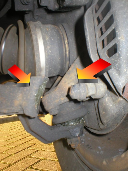

        So I went home glum faced and jacked it up again and had someone hold one wheel whilst I wobbled it side to side it had a fair bit of play in it I don't know how much but it seemed pretty even on each side. I did however notice that on full lock I have a nut on the rear side of my brake caliper grinding against some suspensiony bit check pic you'll prolly know what it is. I have come to the conclusion that my Surfs to low at the front. Would I (a) need to replace the front shocks or (b) somehow adjust it so it sits higher??

          looks like steering stop and should be there..you most probably have read about people hearing scraping on full lock and been told to grease it!

            Pic is perfect shot of the steering stops, nothing wrong there!
            If judders when brakeing, highly likely to be a bushes prob, have had that on many cars.

                  The pic dosent show up to well the wear on the stop the nut thats rubbing on it is worn away big time. Surely grease cant be a resolve?

                    GREASE is the only fix its a common fault. GREASE front & back as there are 2 per side. Even if you get new bolt end-caps they will eventually wear down again.
