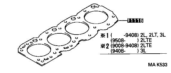

    Can anyone tell me what the Toyota part number is for the head gasket....

    Not sure of the part number but if you get in touch with ukcylinderheads and ask for the Toyota head gasket set then they will supply it. They do genuine and non genuine gasket sets.
      Also note that there are different thicknesses...
      Due to account for poor casting/machining...
      Taken from the EPC for the 2LTE engine on a 2nd Gen upto Nov '91
      11115-54081-D0 8908-9111
      Subs 11115-54082-D0 2LT#, 2L...LN130,8# Mark D
      11115-54081-F0 8908-9111
      Subs 11115-54082-F0 2LT#, 2L...LN130,8# Mark F
      11115-54082-B0 9111-9204
      Subs 11115-54083-B0 2LT#, 2L...LN130,8# Mark B
      So you'll need to have your one off and see which one it needs...
      Also check that these substituted numbers haven't been changed again (since my version of EPC).
      Hope this leads you in the right direction.
