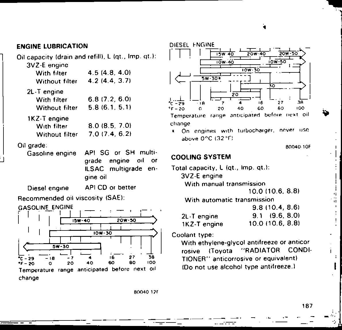

Toyota oil specsOriginally posted by Ronone View PostHi All
I'm Not sure myself how serious an issue this is, but if the big boys like BP and Castrol spend time and money developing an oil aspecialy for Japanese motors,
maybe there is something in it. Maybe we should ask Toyota. bye the way does anyone no what oils Toyota recmend for the Surf ?
