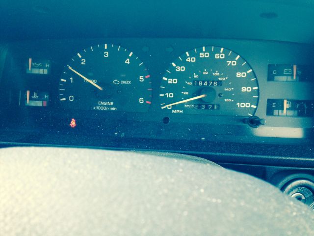

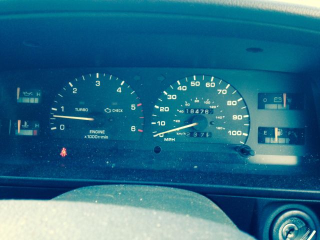

    A mate took my Surf for it's MOT while I was at work and reported back that it was difficult to get any power out of it, it seems to start ok with the new Varta batteries, I thought I'd post a couple of pics of when I take the revs to 2000, the needle on the oil gauge rises by about a quarter of the way, I haven't checked it on a drive yet due to being at work.
    more info needed dude....turbo light on?
      didn't realise that the pics didn't post, checked them again and no turbo light showing. Having said that, the revs are only sitting at 1500. I'll take it out on Saturday if I don't get a chance before then and report back, I know my turbo is on its way out, theres some play on the spindle so might be worth checking out a replacement
        Good luck.
          This "loss of power" was it a problem before mot?
          Did your mate abuse your truck to/from mot?
          Or maybe the tester revved it's nuts off during test.
            No, it wasn't a problem before the MOT, it has been off the road for over a year while I rebuilt the engine after the head cracked. I know it wouldnt have been abused on the way to or from the MOT and it wasn't over revved during the MOT. I'm thinking its the turbo, but can't be sure until I get to drive it myself.

              No turbo light and 50mph needed a down hill.
                Mine did look a bit like that, suspicions confirmed then. Ho Hum, I'll start looking for a replacement turbo
