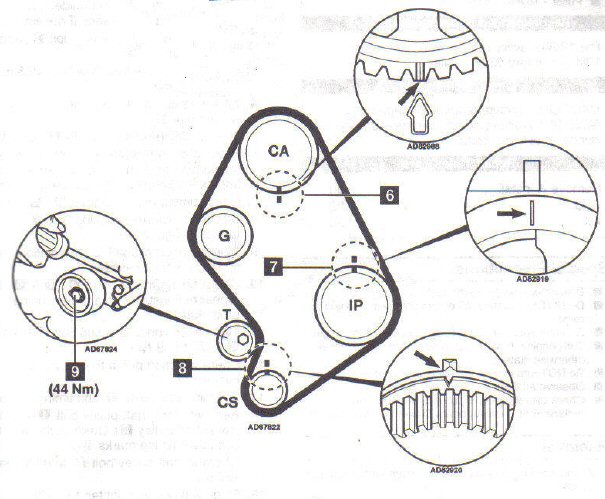

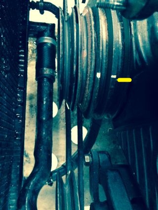

Dismantled the front of the engine again today, found something that might provide the answer (if I'm seeing it right).
Looking at all the timing marks and positions of the pulleys, when I look at the timing marks on the crankshaft pulley they appear to be approximately 1 tooth out from the metal prong that sticks out (timing prong?). The camshaft pulley is lined up at 6 o clock and the injector pump is lined up at 12 o clock but the crankshaft pulley seems to be one tooth away from lining up, could this be my problem?
I've posted a pic , timing marks on the pulley in white and the prong that sticks out is in yellow, I know it looks close in the pic, but when you're stood in front of it looking down at it, it appears to be out by 1 tooth.
I'm thinking that in theory, I need to adjust the crankshaft by one tooth to align everything perfectly?
Originally posted by RebelV8 View PostI'm thinking that in theory, I need to adjust the crankshaft by one tooth to align everything perfectly?
Yup.
It's been a number of years since I've tinkered with a 2.4, but the 'trick' was to set the crank timing mark one tooth before TDC so that when the tensioner was released, the belt 'pulled' the crank mark into position, IIRC.
