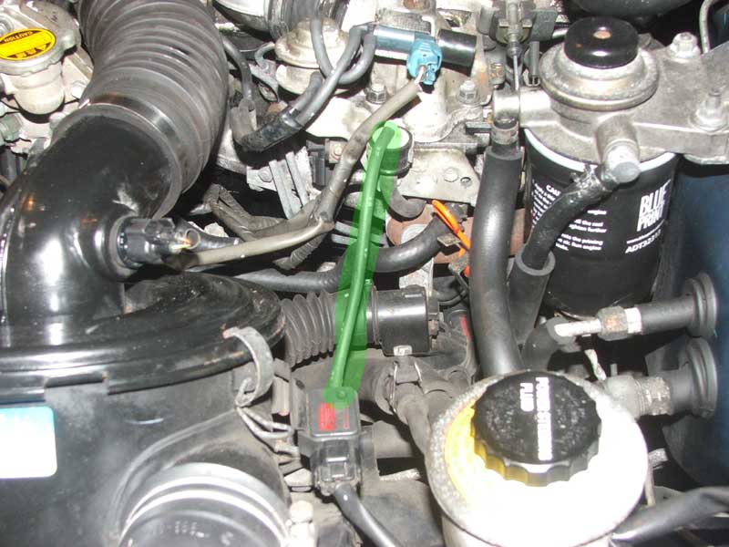

    Help you this picture?
    see you red mark
      On the air filter housing is the Turbo pressure Sensor. The hose from top of white filter connects to the botom of the Turbo Sensor.

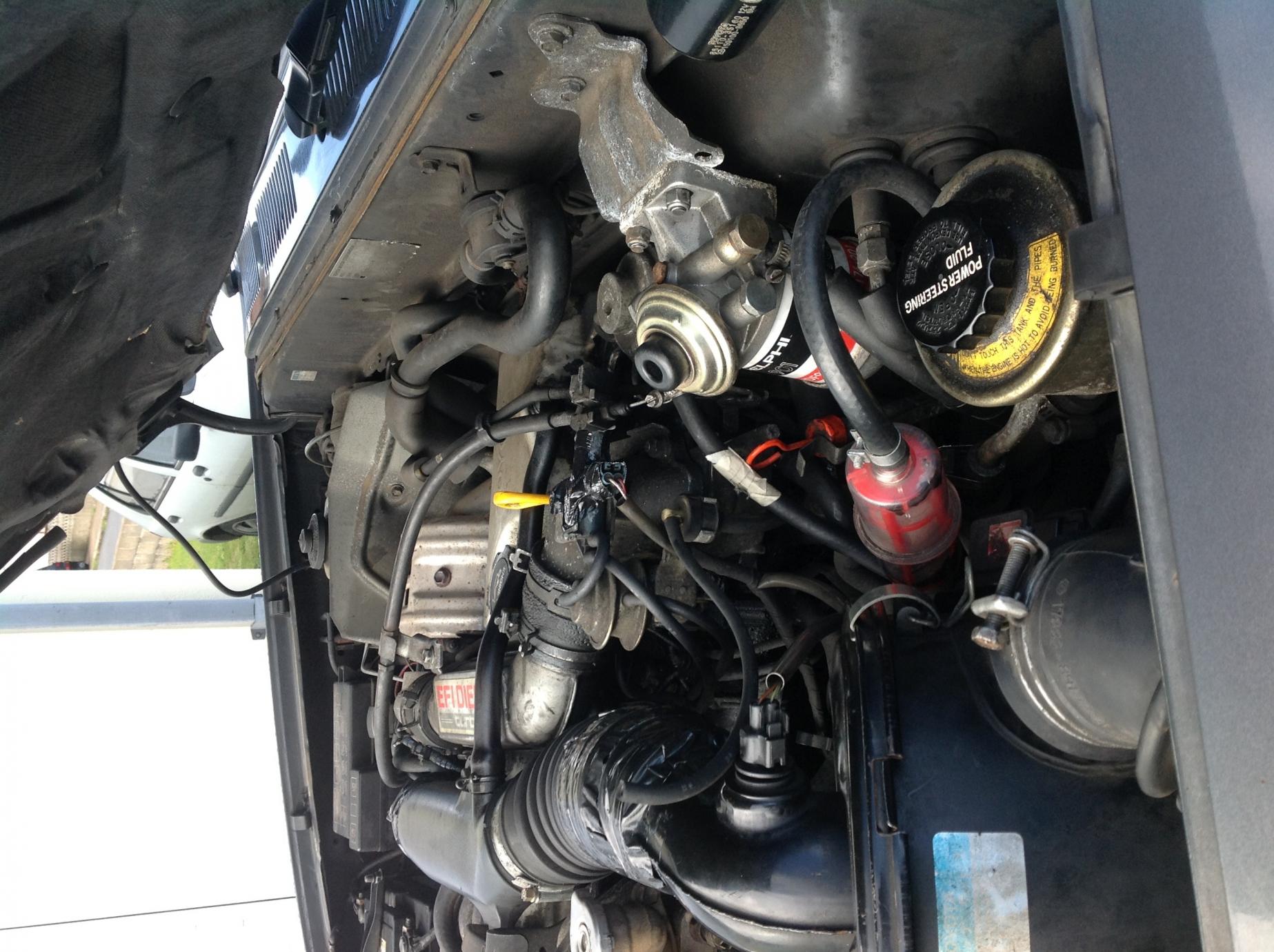

        Hi here is a pic of the hose I just can't see where it goes. It's the one sticking up in the air at the bottom of the picture.
          see what's marked in green. Vacuum hose is inserted into the pressure sensor, the one with red label
            Ah yes thanks guys I've found where you mean all working again now, sorry bit of a numb nuts on my part I couldn't see for looking lol
              a lot of tape on hoses and electrical connectors in that pic?
              My 4x4
              My choice
              Back off
                Yeah, better replace intake hoses before you destroy the turbo with bits of hose going through it. The elbow between the plastic crossover tube and the turbo intake will crumble and bits will get sucked into the turbo.
                Nev.
                ps; Can you rotate pics before posting. I already have a sore neck.

                  Hi yeah sorry about rotation took pic with ipad and uploaded without knowing what rotations it was. I'm awaiting new hoses (ordered them today) but will prob take at least a week to get them due to being here in Alderney C.I although Roughtrax are generally pretty good at geting stuff here fairly quick it just depends if DPD put goods on boat or plane which generally seems to be random which way round they do it. lol
