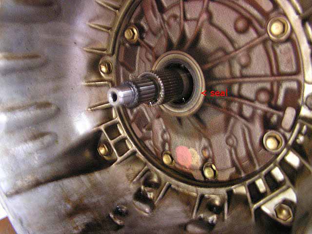

 Most likely the transmission shaft seal thats behind the torque converter.

 Its hugely unlikely it the convertor itself, I've never seen one split, or even badly made, especially a Toyota one, if the convertor is the only part you've reused it maybe the pump drive shaft is damamged and not sealing.
 Are you putting the convertor on the gearbox, then installing it on engine or bolting the convertor to flex plate then fitting trans? if the latter its all to easy to push the seal in to far or twist it and it leak.

 Always fit the torque converter onto the transmission shaft before attaching to the engine.
