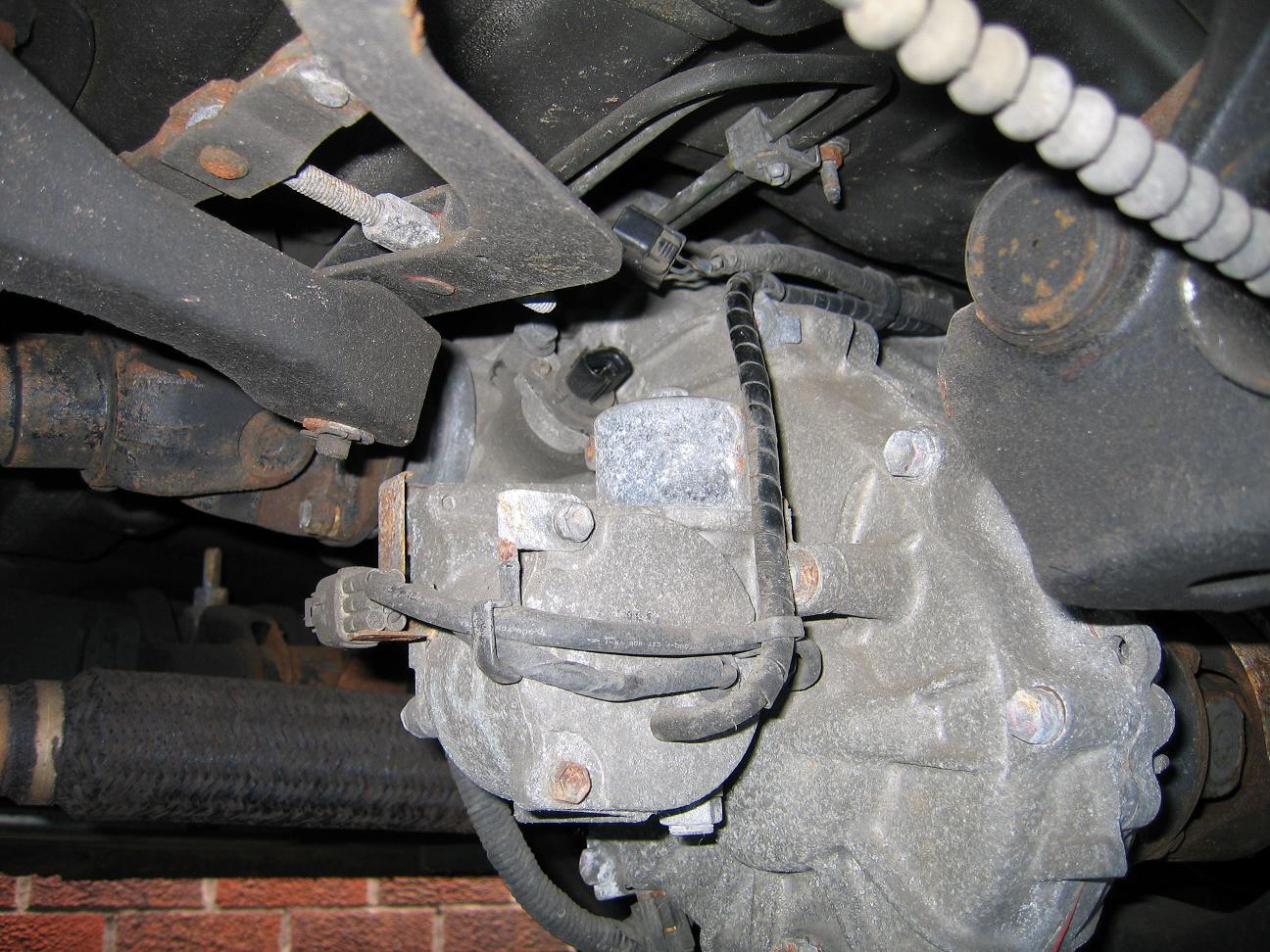

                    The sensor for the speedo (MRE) is the one nearest the rear propshaft. Black plug, three wires.
                      I think I have located it, here are some pictures.
                      Ian
                      One day my paranoia will go away!
                        Yeah, thats the one.

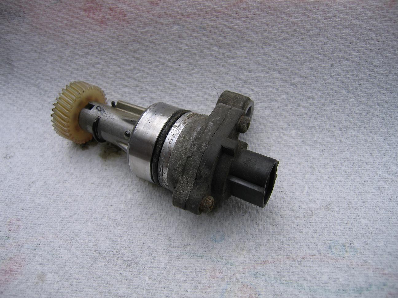

                        You can bench test it if you have a multimeter.
                        Look at the plug end of the sensor and you'll see tiny numbers, 3 2 1.
                        Apply 12v to pin 1.
                        Earth pin 2. plus the negative probe of multimeter.
                        Positive probe of multimeter to pin 3.
                        Set meter to 20v DC, switch on power supply and turn the plastic cog on the sensor. The voltage reading should fluctuate between 0 and 9 volts, if it doesn't then the sensor is stuffed.
                          OK
                          Tested the sensor tonite.
                          Was getting 2.3v dc output on meter without turning.
                          No fluctuation when turning.
                          I guess the sensor is faulty.
