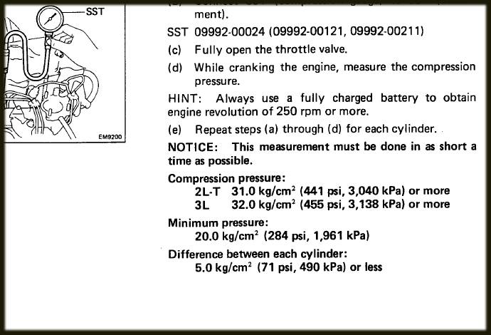

Hi All,
Have just received my compression tester so will be checking my '93 2.4 at the weekend. (Had problem with the crankshaft seal working loose)
I need to disable the fuel supply when I test and have just searched for 'fuel cut off solenoid' and think I won't have one as it's a 2LT-E. (spill valve instead?) Is there a simple way to stop the fuel ? I'm thinking remove the fuel filter and crank a bit....
Cheers,
Rob.
