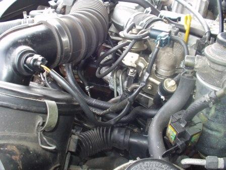

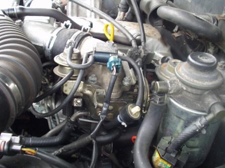

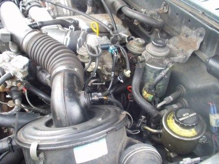

Have started a new thread albeit on a previously covered subject. There is no turbo boost on my 2.4 'H' plate SSR-X. The sensor is on top of the throttle housing on this model, as opposed to by the air filter. The turbo impellor is spinning, all pipes that I know of seem ok and conected, there is suction at the impellor when the main hose is disconnected and i place my hand in front intake. The green turbo light comes on at switch on only. On the pic supplied by Bushwhacker in response to post by Highlander (I think) there is a diaphragm type item with hoses coming from it. These hoses disappear to the front and below the throttle unit and connect to metal pipes.
There is a white top filter (?) of somekind that is shown connected by red dotted line to a nipple on side of throttle unit, again on Bushwhacker's pic. Question 1: what is the purpose of this? It was disconnected as a result of work done by A.N. Other. Connected or disconnected made no difference. Question 2: what is purpose of diaphragm-type item with grey tubes coming from it and how is it linked to turbo? How can it be tested? Question 3: If the turbo boost pressure sensor is u/s, will this cause turbo to not funtion? If so how can this be tested other by replacement. Question 4: Were I to replace all these items, who would the parts be obtainable from? Question 5: Apart from torching the damn thing, any suggestions as to why turbo not kicking in?
