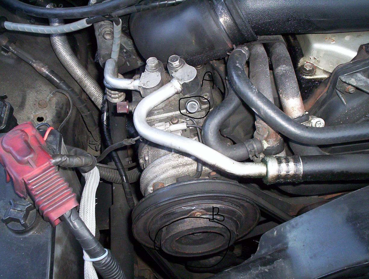

                          i have the pics just hope i can upload them for you and omg how dirty is my engine bay just found the next job!
                          compressor picture most professionaly labelled "a" is schraeder cap
                          "b" is clutch.

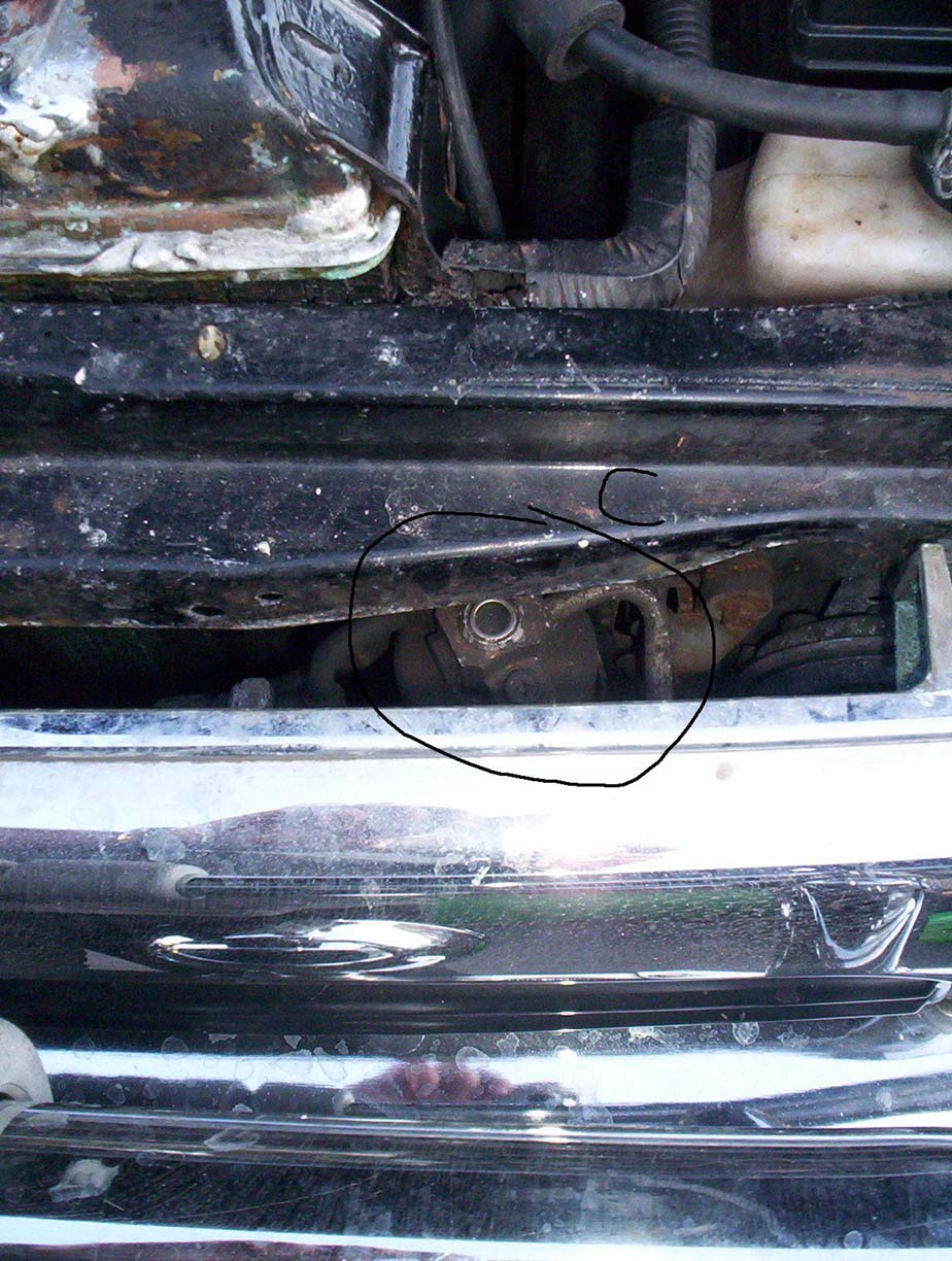

                          receiver pics shows what you are looking for behind grille and in front of rad

                            thanks mate the outer part spins with the belt on but cant see the inner part spin should it be
                            will look for the other bit tomoz
                            cheers again
                              yes the inner part should spin with the a/c on ,perhaps if you could get some one to turn on the a/c as you look at the compressor you should hear a click and the inner will start spinning.
                              if it does not then you move on to the next step.i do not know your level of competency please dont be offended if im teaching you to suck eggs but please procede with caution.
                              with the engine off,and ignition off you could try this strip off some electrical ]cable at both ends .unplug the little connector on top of the compressor poke in the stripped end and then with the other end lightly brush the positive battery terminal .you should then see the compressor clutch pull in.leave the stripped end in the little connector and leave the other end out of the way of any spinny or electrical bits,
                              jump in your truck and start the engine turn on the air con then very carefully touch the postive terminal again but leave the wire connected Insulted crocodile clip is good.fused is even better.
                              with all of this done look in the window (2nd picture)and you should see fluid moving or bubbles ideally the little window should either go clear or have more fluid than bubbles.
                              if this is the case and you can feel cold air coming out of the cabs vents
                              ten you have an electrical problem.

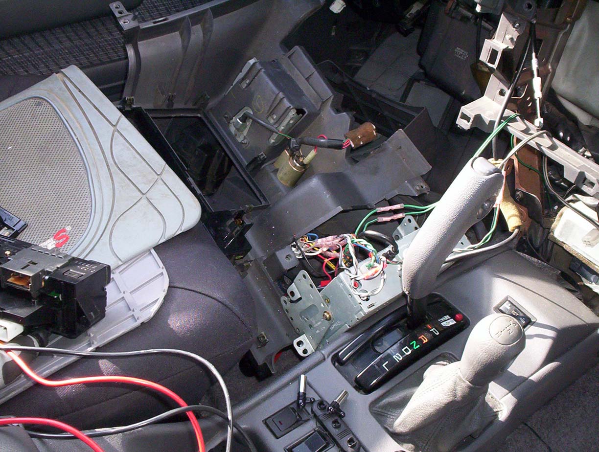

                              my a/c was not working when i was given my surf i found that the fan speed slider switch was fubar.striped out switch assembly and remade switch,also
                              i think the fan fuse had failed good luck
                              check out the pics
