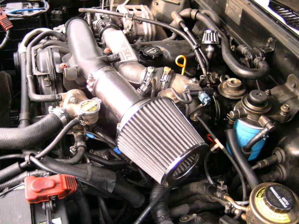

hi guys final thought found this image
and was wondering 2 things
firstly was thinking of mounting the sensor in the new blue pipe would this be ok and work fine
secondly what does this sensor do can i leave it disconnected without ill effect
all your help is much appreciated wouldnt be going through this hassle but looks like the only way i can get away with fitting a side mounted intercooler

As to leaving things disconected i wouldnt (the sensors are all there to do a job & the ones you are on about i.e the Airflow sensor & the turbo one do just as they say on the tin and without the engine being able to monitor the airflow it cant work correctly.
Have a look at this for a bit of info http://www.autoshop101.com/forms/h34.pdf and as stormforce said 'turbo pressure sensor.As long as its all connected e.g wires and pipes then it should be ok' is right enough and with regard to the airflow one i would have thought as long as its inside the tube and sealed it should work also.
Hope this helpsThe sh$t gets deeper ...but still swimming
thanks guys a bit gutted i took all the airbox out and installed the new cone filter took it for a spin and no turbo light and lost alot of oomph so decided to go back to stock refitted evrything and still no turbo
after about an hour of checking and double checking found a breather pipe that connects to the sensor mounted on the airbox reconnected and turbo is now back so suppect if i had found this with then new cone on all would have worked
