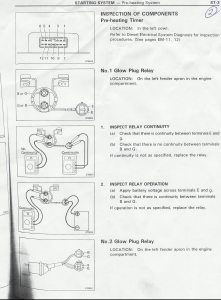

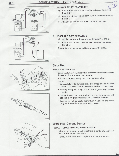

            Hi Sanch, no not done the injectors thing but i can (i think ) hear the relay click. Is there a way to check it.

                How do i check voltage to glow plugs??
