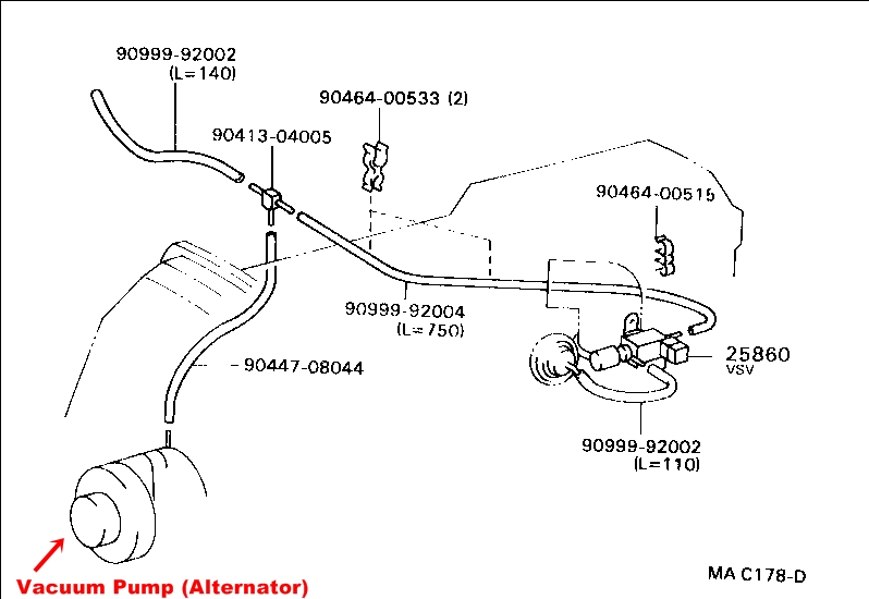

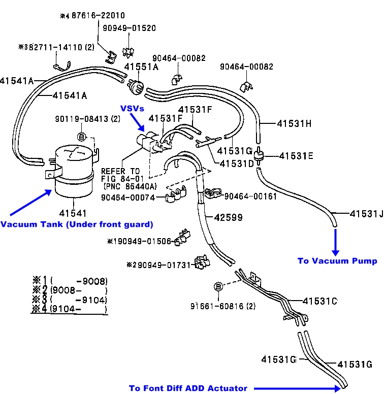

I have read all the post about checking the vacum pipes and the following images show where there might be somthing missing. I cat here any click (apart from switch on knob) when i try and select 4wd nor does the light come on.
Theres this one on the driver side, this thingy is flapping about and look like it once had a vacum pipe on it.
Or this one on the passenger side (not very clear) again looks like it shoul have a vacum on it.
If i get a volt meter can i tell if the solenoid on the front diff is getting 12v whilst the car is stood still?
