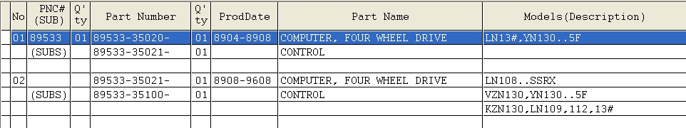

                        89533-35100 is probably the 4WD control part number you need.
                        Can't find any info that would suggest it should be anywhere but the same place as a Surf.
                        Nev
                        • #42
                          It seems that tha 4WD control from the KZN and VN130 is the same as the LN131. The LN130 is a different part number.
                          Note that the above part number has superceded -35020 and -35021 so anything with these will be the same.
                          Nev
                          • #43
                            Nev
                            Sorry mate, i havent got clue when it comes to anything other that Vw's. I guess LN131 is the model, does that mean it has to come from the same car or just the same generation e.g surf/hilux of a similar year
                            • #44
                              As long as the part number is 89533-35100, -35020 or -35021 it should be the right one. I hope someone with an LN131 4Runner can confirm this. This is a list of vehicles that should have the same.
                              Nev
