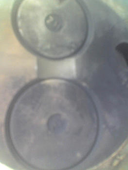

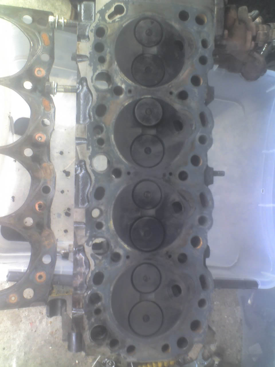

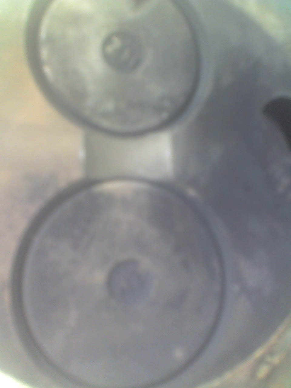

Well head out and no visable cracks ,so going for crack test & Skim at engineer's 2moro.
So i'm back on the merry~go~round of solving the overheating ,and took the head off for nothing.

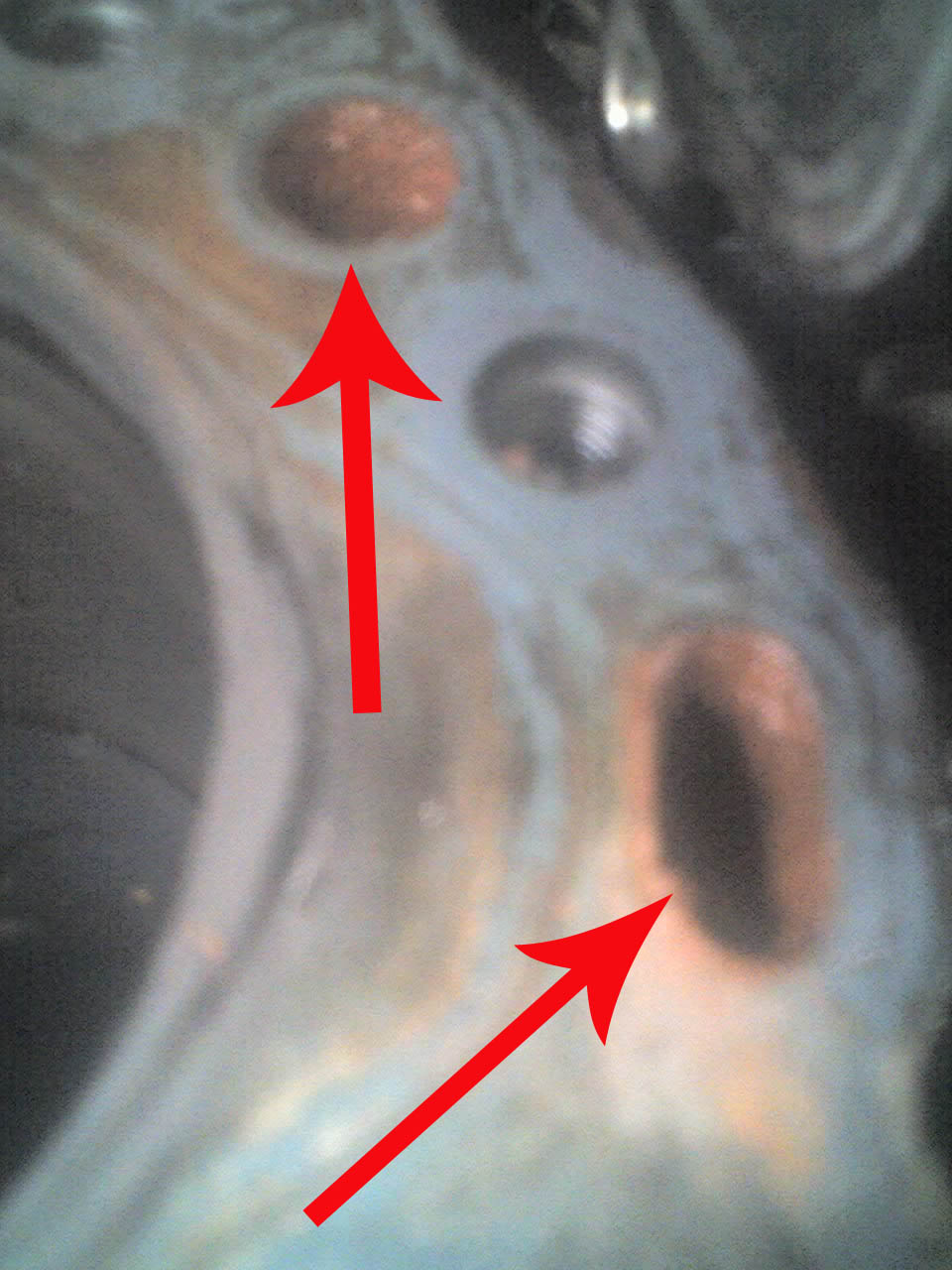

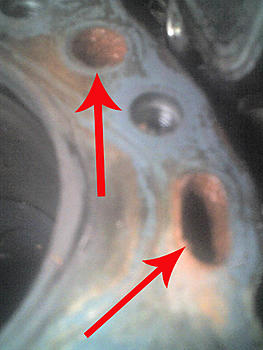

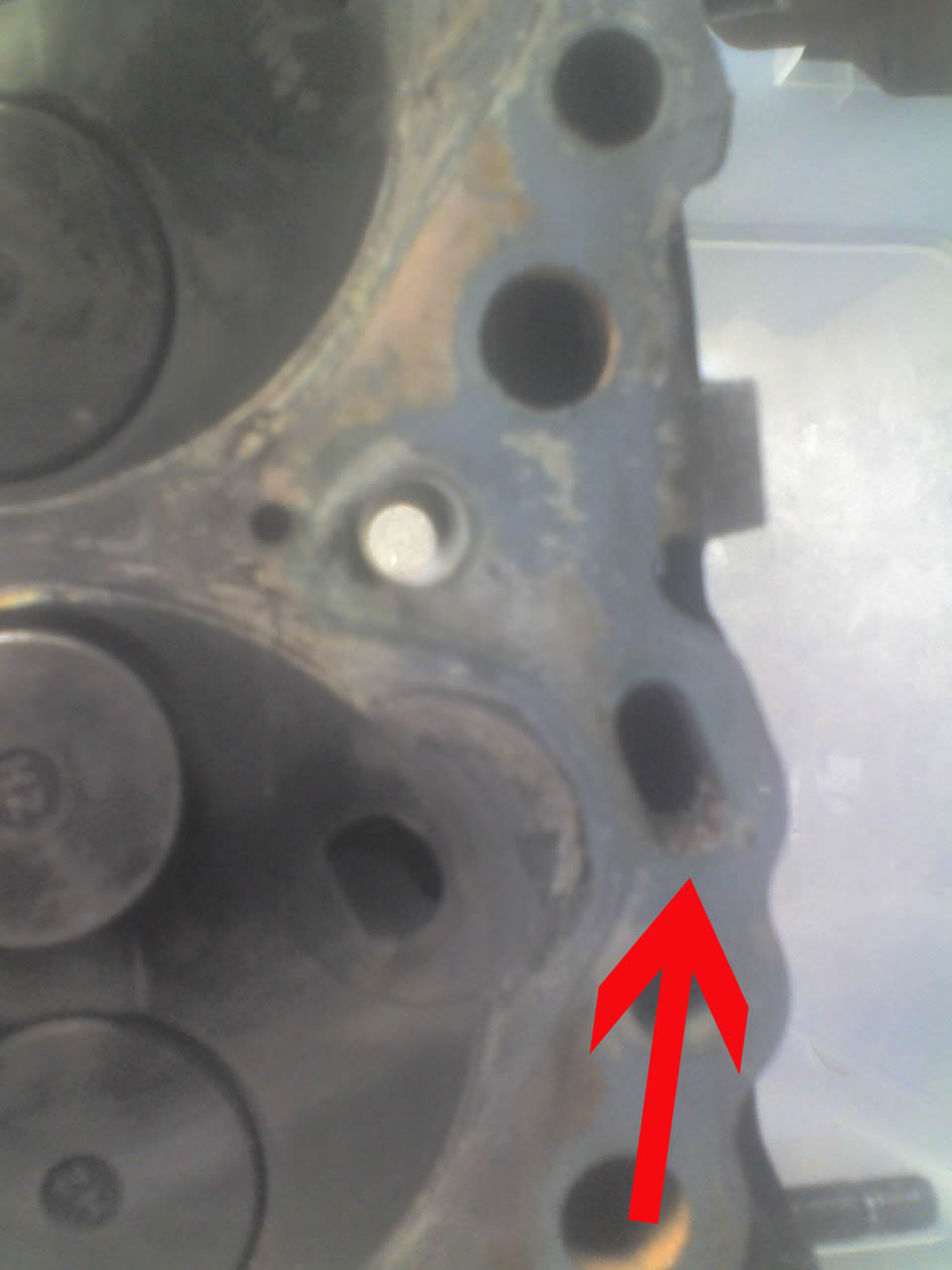

The water galleries on the head & the block ,the oblong ones which are blocked by the gasket were all full of crud (iron fillings) . So i will flush the block waterways.

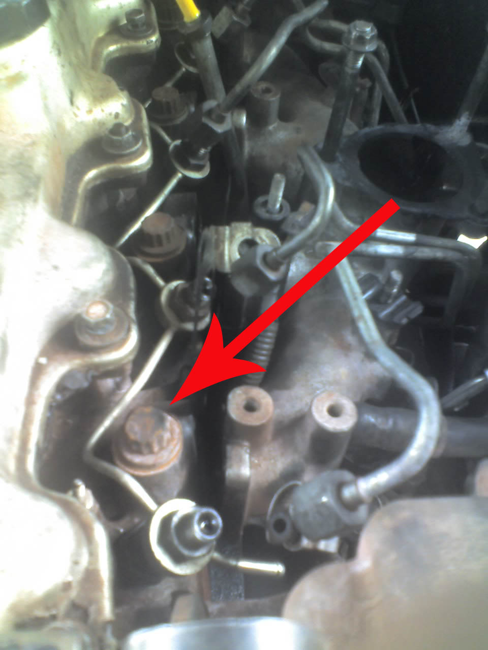

4. Them head bolts with their 12 point stars ,i got em off with a standard 14mm socket ,but it was'nt a perfect tight fit .So im concerned that when torquing up i might sheer one off ,so where do you get them exact sockets as a trip to halfords only had 14mm 8 pointstar sockets ?
Head is cracked at valves on cyl1 ,not that i can see it but thats what engineer says. Maybe ill get a new head ,but on checking the block the waterchannels are full of crud. So i removed Block drain plug but nothing came out ,i can see water in waterchannels on top of block. Tried poking a length a coat hanger up the plug hole but its solid. So unless i can clear & flush block i dnt think its worth replacing head.
Has any1 ever got the 17mm nut out of the block what the block plug screws into. As the brass plug came off easy ,but the longer 17mm nut in the block is super tight and maybe locktighted in?
