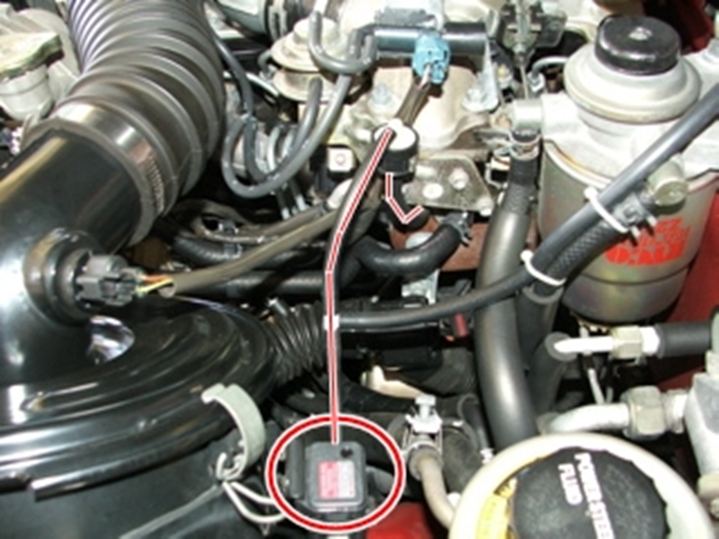

              There is a diagram on page two here - http://www.toyotasurf.asn.au/forum/viewtopic.php?t=9859 - which shows the 2L-TE vacuum setup. The only other one is the Turbo Pressure Sensor hose from manifold to sensor.
              Pic below.
