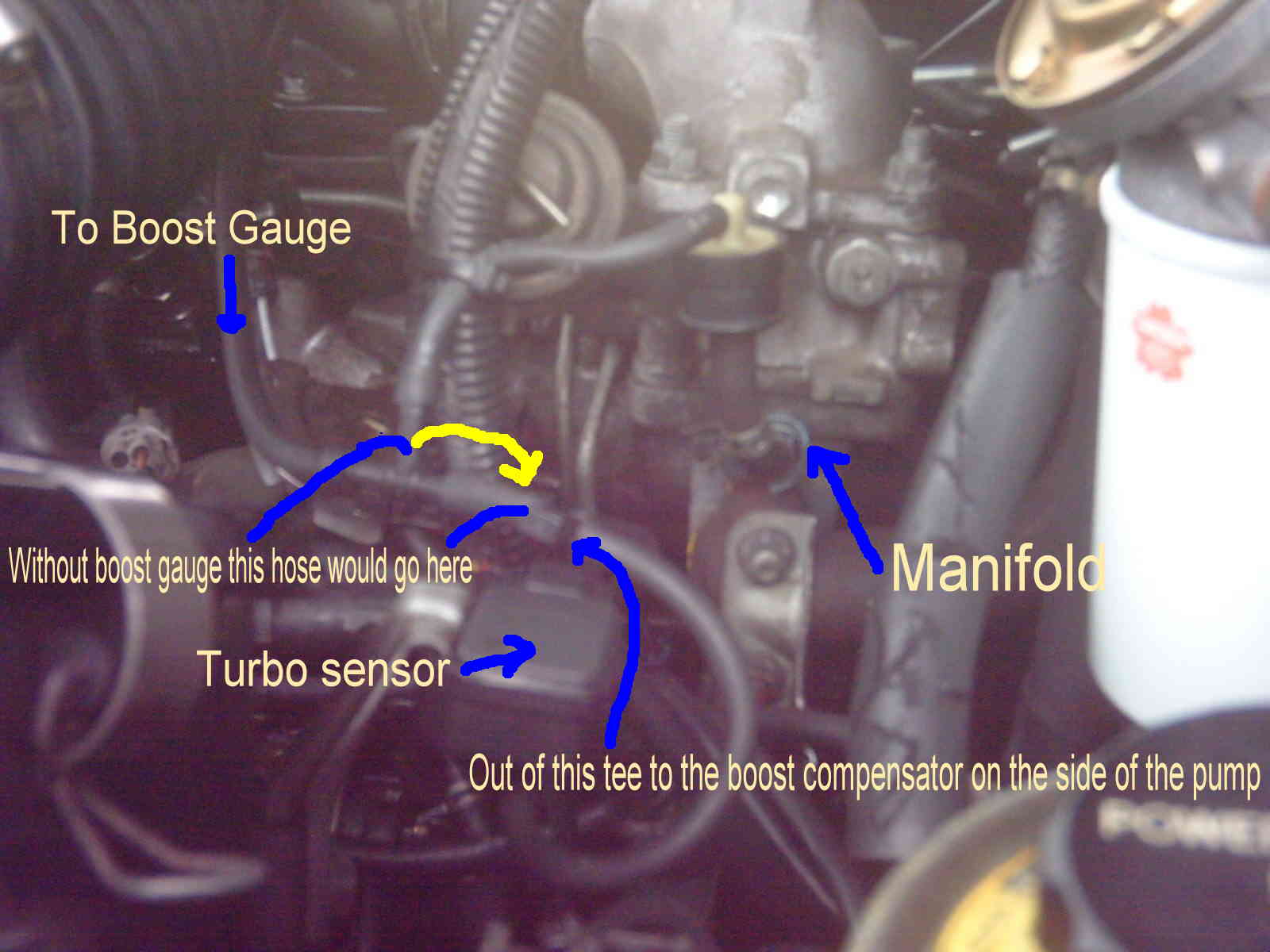

                            O.k for those that have missed the main point here it is.
                            There is only 3 things that have this pressure line attached.
                            "One that comes out of the manifold just above the egr inlet through a little black and white thinghy ( a filter ?? ) ---into a tee, 1 line goes to the boost sensor beside the airfilter and the other goes to the fuel pump to what I assume is the boost compensator."
                            You can add a fourth if you route a line to a boost gauge.
                            ALL the other hoses are gone including the little coloured switches.
                            IMPORTANT NOTE
                            Mine is a 2.4 with the mechanical fuel pump NOT the efi.
                            The attached photo is not to clear but may help.
                            Simon.O.
