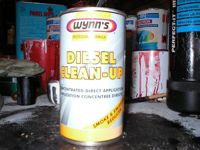

                Just to add to that, before fitting the new filter, fill it with this and it will give your injectors a flush/clean.

                  Thanks guys
                  kev
