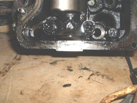

    ....but I've had to stop rebuilding my Surf because I don't know which way around the tiny half-moon oilseal at the back of the camshaft fits - should the flange be inside or outside? Inside 'feels' right, but I suspect it's outside as otherwise the face or the half-moon would be very close to the camshaft end.
    Also, to fix it in I've got a tube of HYLOMAR UNIVERSAL BLUE Gasket and Jointing compound - the box lists cylinder heads as a usage and temps up to 250C - is this OK to use?
    Finally, the workshop manual says to put PACKING around the front and rear upper surface of the head under the camcover rubber gasket(just in the 4 small areas on either side of the camshaft where the ali components meet). The other workshop manual says to use sealant in these areas. Would 4 blobs of this HYLOMAR be OK for this purpose also?

    my head-on-a-bench came in handy after all
      Thanks very much JimL - photo is much appreciated
      Anyone know if this Hylomar Universal Blue is OK for fixing the half-moon back in?

                  Should be in the oposite way to the one in JimL's picture, flange goes on the inside, it's stopped being pushed in by the end of the camshaft and being pushed out by the flange. Sealant is fine but not really required.
                    Sorry bout that Jim, if lucky is right then mine was put in wrong years ago coz I didnt touch it, didnt even notice it till you wanted the info. Either way it didnt leak oil, and it did have a white/grey sealant on it.
                      thanks for your help. i've fitted it with the flange facing inwards with regular silicone sealant.
