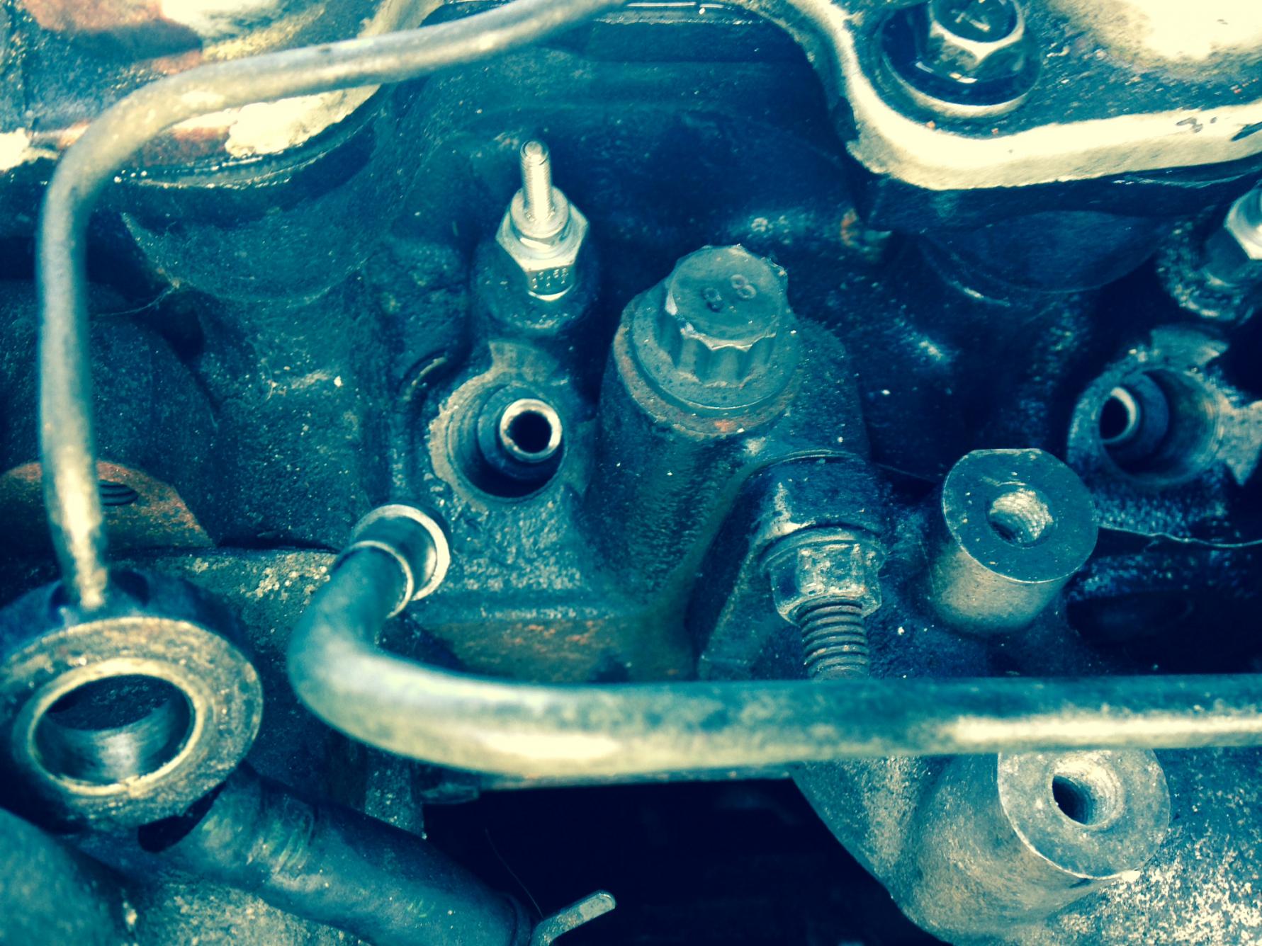

Managed to get the old injectors out, the new ones obviously have new copper washers and little crush washers with them to go in the whole that the injectors go into.
The old ones came out and left what can be seen in the photo, is there a trick to getting the old washers out?
I've tried using a magnetic screwdriver but they seem to be firmly stuck in, don't want to risk causing any damage
