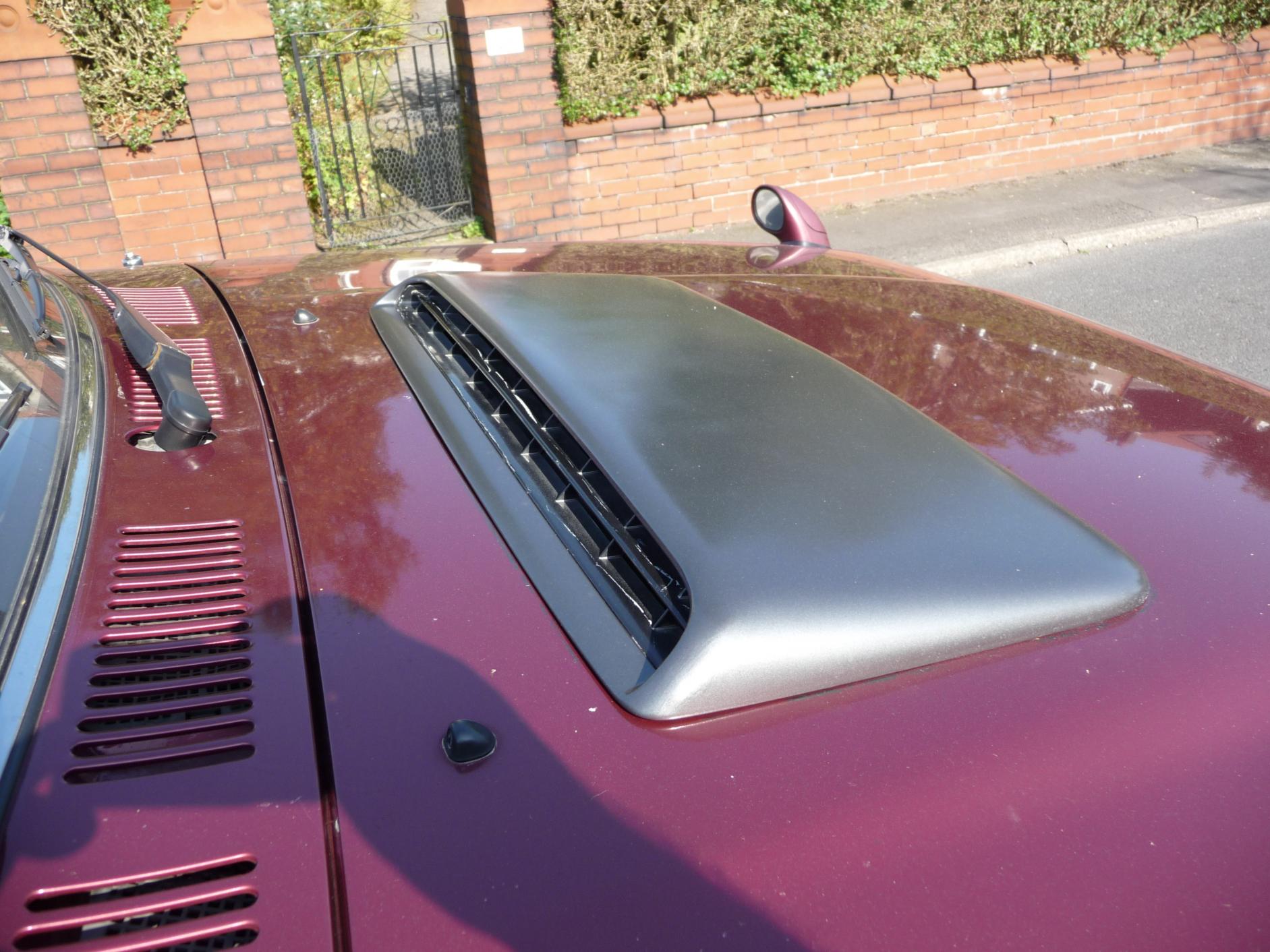

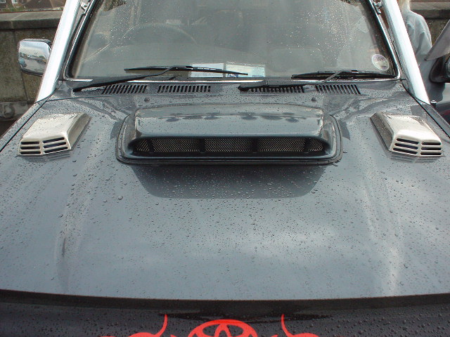

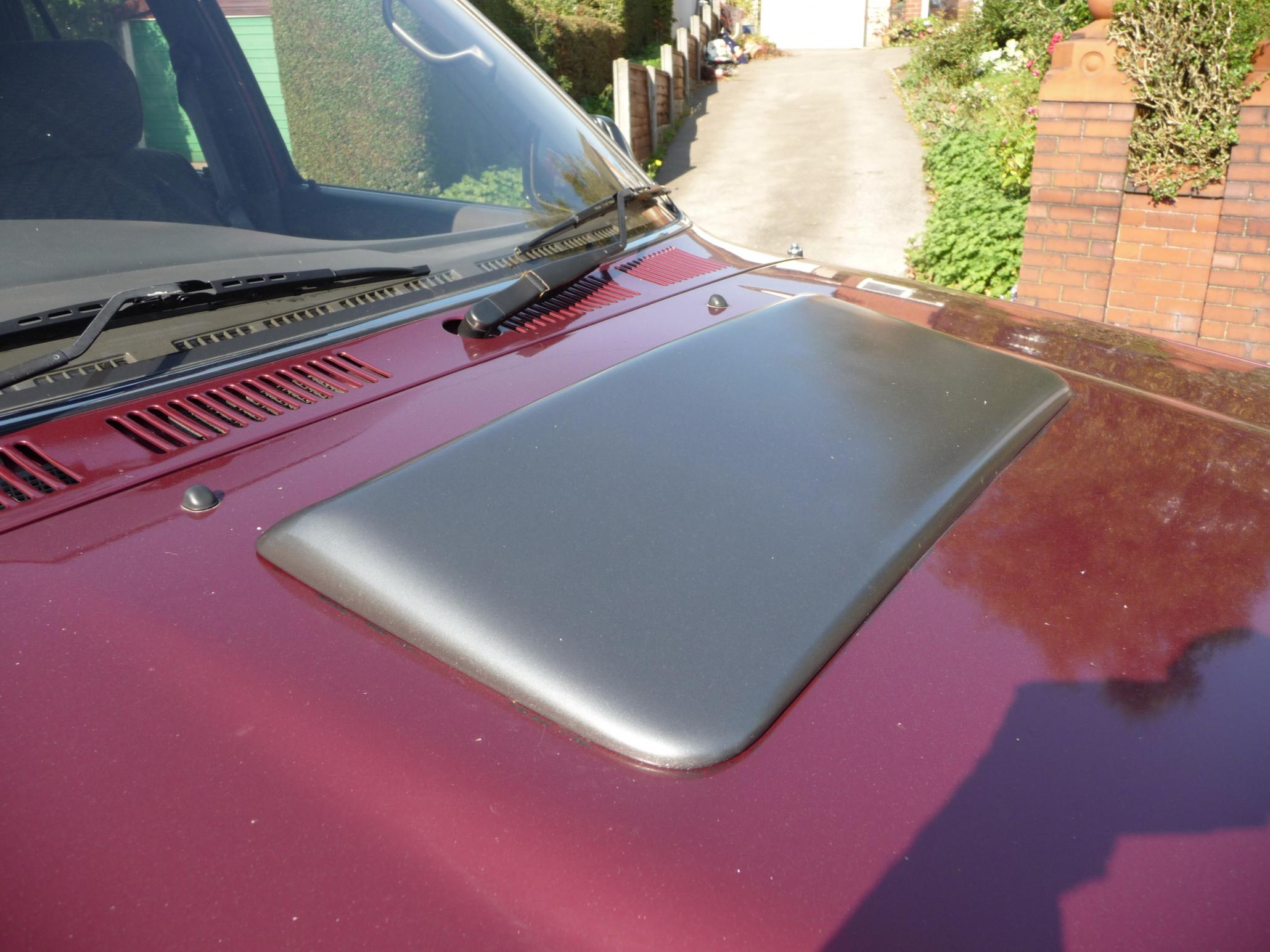

Bonnet Scoop
You need vents not a scoop if you want to release under bonnet heat.

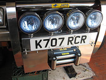

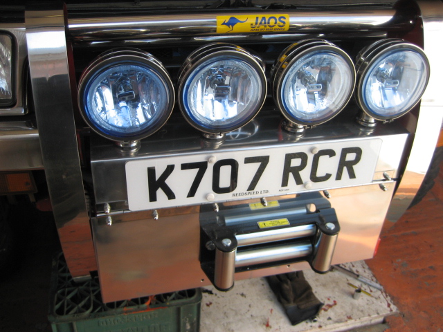

but the scoop is for getting air through the intercooler, plus i do have some restriction on the front (winch box) small vents work fine, i can see the heat shimmer comeing out, also a body lift lets more air flow through as the trans has a larger gap between it and the tunnel,
