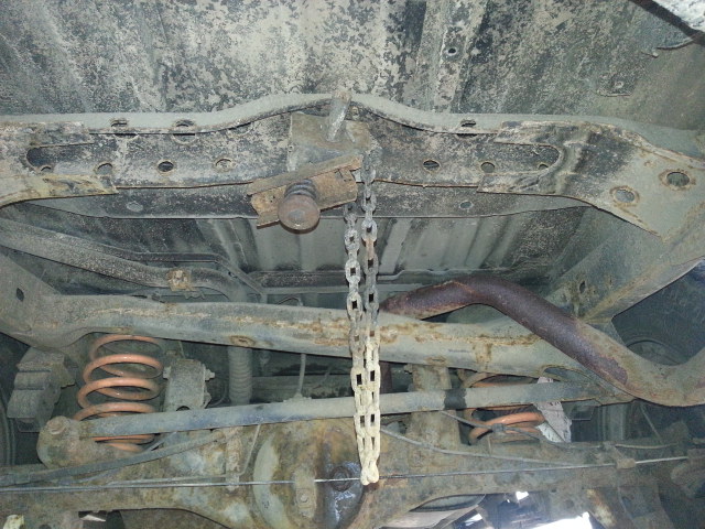

            You may well beat me to taking the pics, Lightyear. It's chucking it down with hail and rain here with strong, blustery winds to make sure the cold gets to your bones.
              Hopefully this will help
              Quis custodiet ipsos custodes ?
                It does indeed - I thought it was made of more parts than I can see there. I can't quite tell as the part that joins to the cross strut camouflages in quite well but would you say it looks similar to this :
