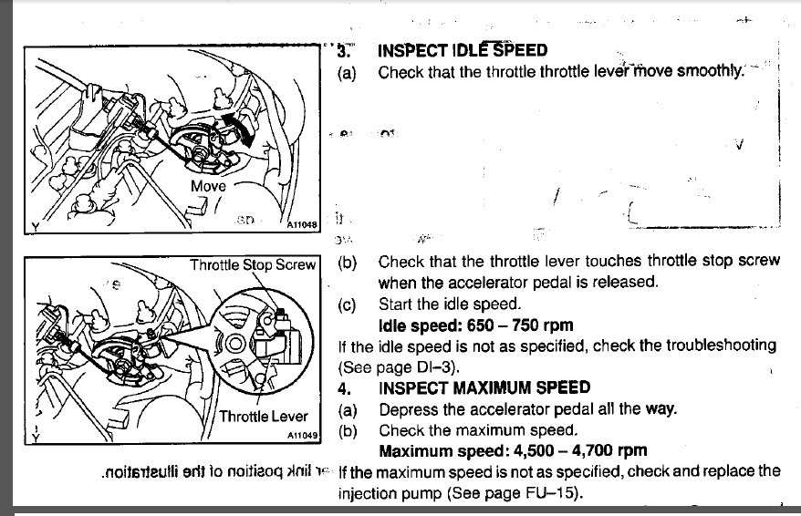

Hellooo..just had a quick look, as usual its just started raining and it's a bit dark but will look again in the a.m. Tx for diagram, I need it simplified sometimesOriginally posted by wishbone View PostIs the throttle cable completely closed on the inlet manifold ? The bit the cable attatches to should be resting on a stop screw.
