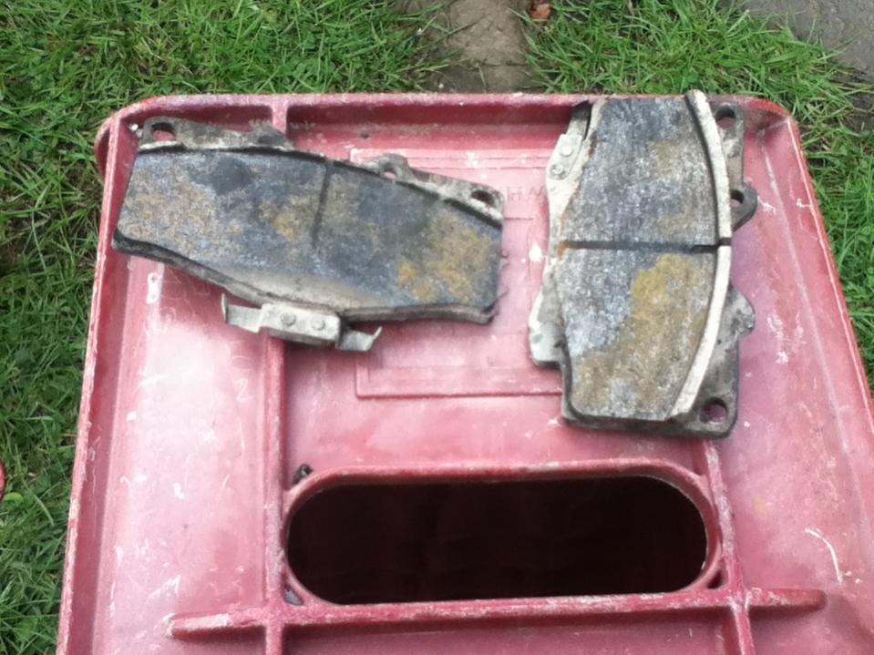

Well after having a tinkling sound on and off since my last off road jaunt I had convinced myself I had picked up a small stone that had lodged itself in the drivers side front wheel .Off came the wheel so I could get a better look ,had a good root around the inside the disk backplate ,nothing.
Gave the wheel a couple of turns and lo and behold back comes the noise ,yep wear indicator just skimming the disk surface.Disk pads at the limit.
Quick phone call to my local motor factors they have them in stock £22.00 .
Pulled the pads out and was quite alarmed at the ridge on the pads .I am sur the last set of pads came from R/T.
