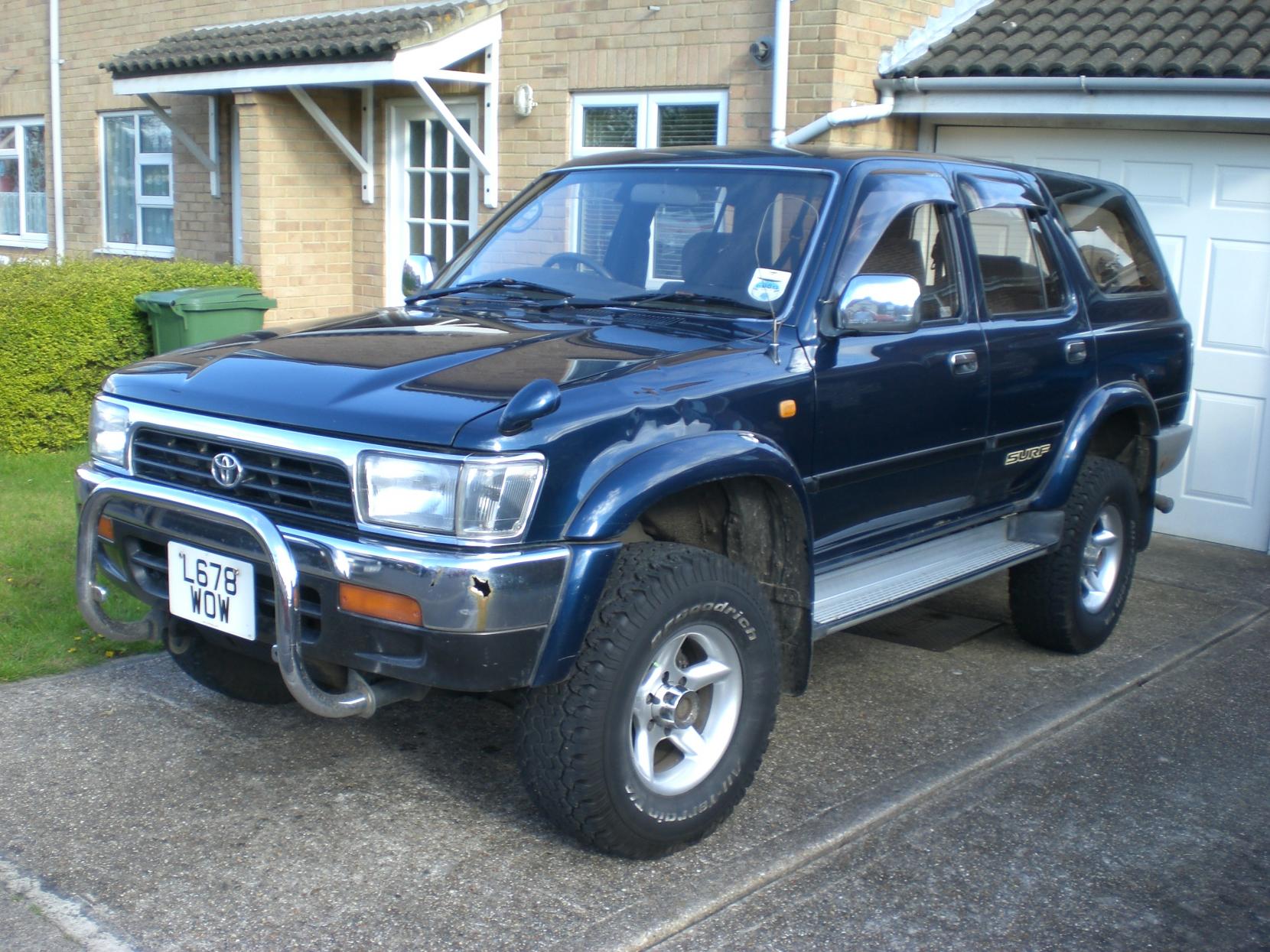

                  How can I be certain vehicle is 2nd generation - what is the definition?
                    Looks like this
                          The chassis plate will have KZN185 on it if its a 3rd gen or KZN130 if its a second
