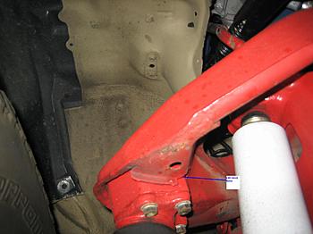

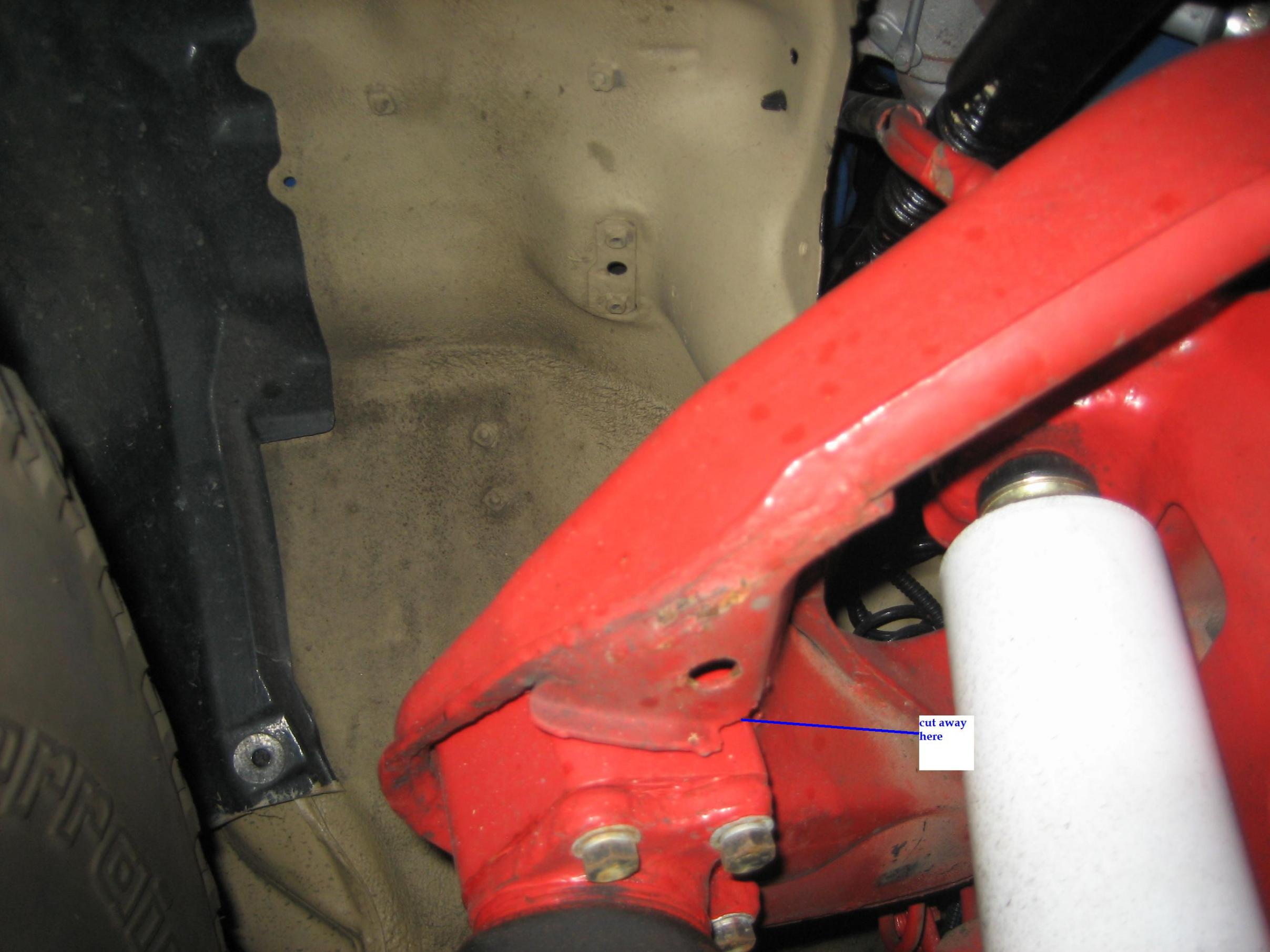

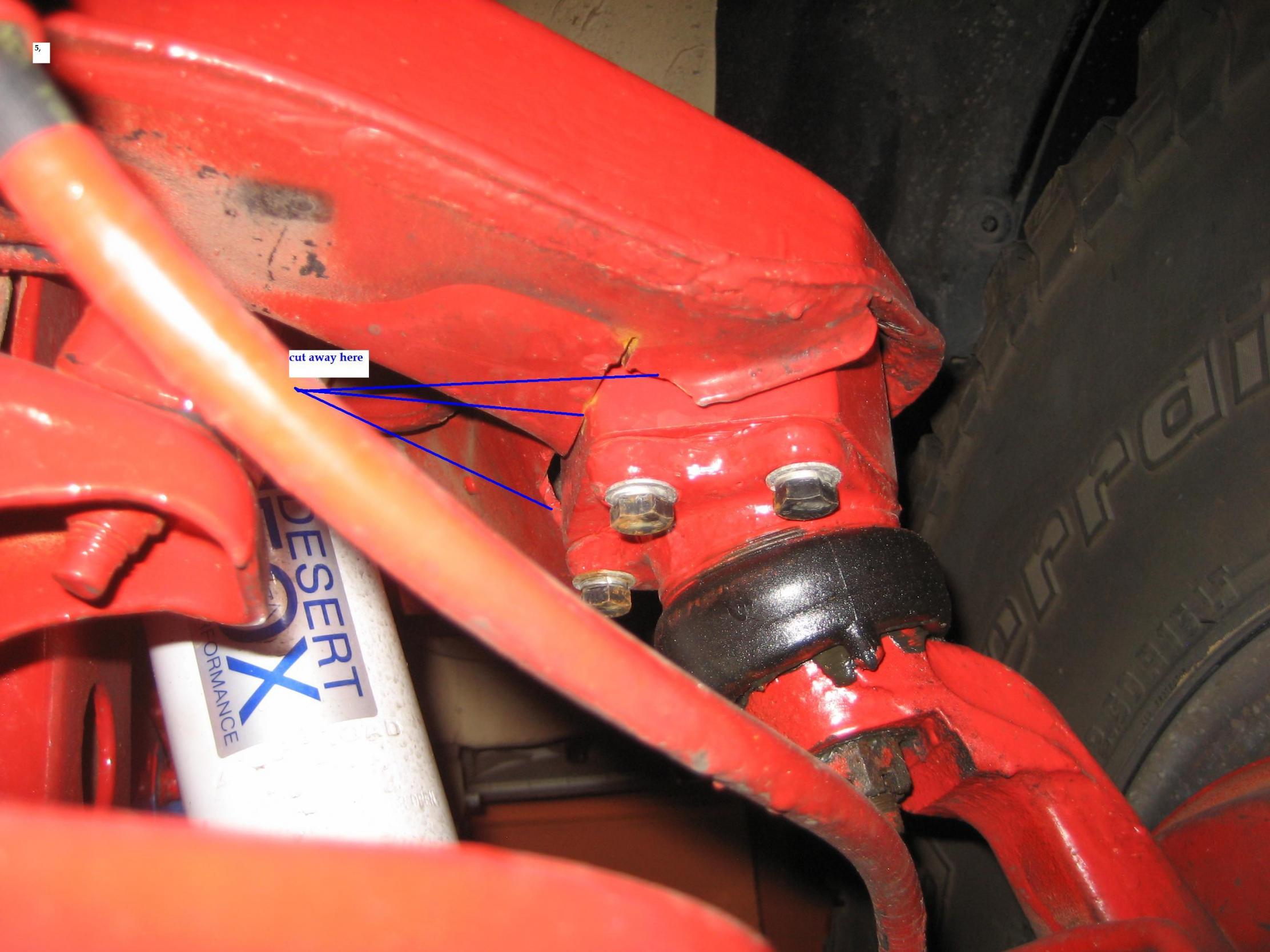

                            • #29
                              The spacers fit under the top wishbone and the bj like in these pics, if you go for 1 1/2" --2" you have to angle grind some of the underside of the wishbone so the spacer blocks fit snugly to the upper part, a bit arse quaking but grind a bit at a time till they fit ok, also dont forget with these spacers you will need to get the tracking and camber etc done as they will throw it out a lot,
