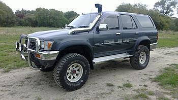

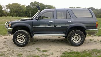

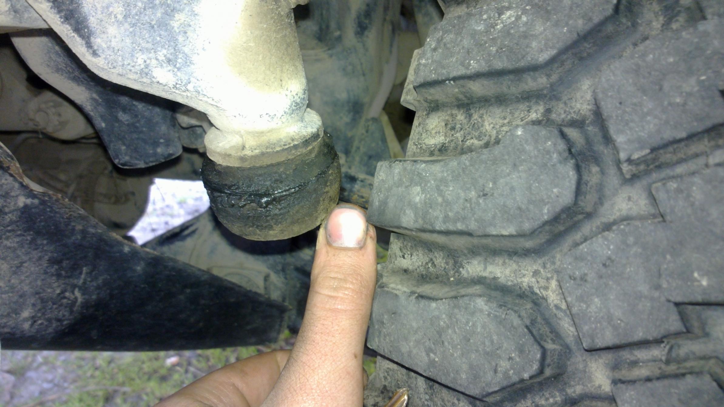

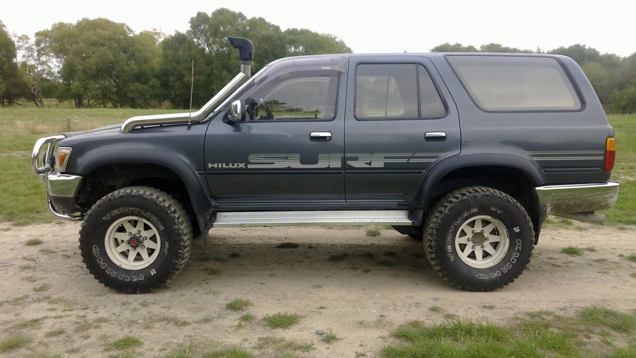

          I have a 2 inch suspension from uprated springs and wound up tortion bars, and a 2 inch body lift to fit my 33's.
          They fit and dont rub at all even at full lock but I must stress that this is only because I have a good amount of offset on my rims and when I say they dont rub I mean they dont but only just, see photo, (cant even fit my thumb nail in between), so trust me and a few others when we say that just a 2 inch suspension will not fit 33's.
          If you never 4wd (you would be mad not to with a surf ) you will have enough clearance height with 2 inch suspension but still rub at full steering lock regardless.
          Stick with some good grippy 31's unless you really need it and can afford to do it properly, suspension is too important to take half arse measures modifying
