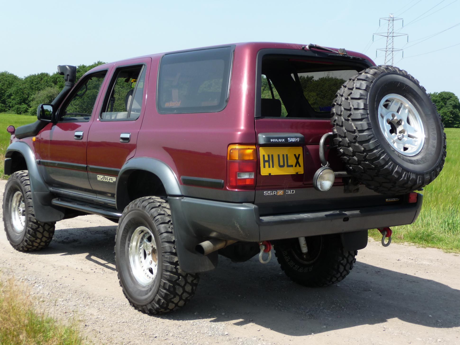

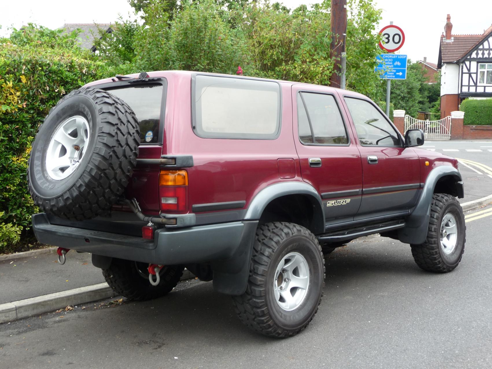

i would defo not have the 305 on an 8 rim - wouldnt look right, let alone handle well
shame your at the other end of the country as I'd say come round and have a look/drive/try on of one of mine..
If i could wind the clock back tho i think i would have gone for Cooper STT or Khumo KL71's over the GG's..
The GG are better on the road, but seem to have sidewalls that catch off road and aren't as well protected by chunky shoulders like the other 2, but then i do probably 50% off road 50% road..
if on road a lot more then the GG's would be great..

Are they the 33/12.5s or 33/.10.5s?
