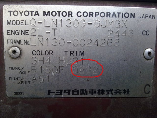

Don't mean to be if I sound stupid but if it is geard to high so it revs out top end would bigger tyres alter so it brings the gearing down ?
Your speedo's always going to tell lies once you start changing diffs and tyres like me as its speed sensors taken from the gearbox.
And yes bigger tyres going to change gearing down, hence how I said people often have the 4.8 diffs like yours on 33's, poor old 2.4 would struggle to turn 33's on 4.3 diffs
