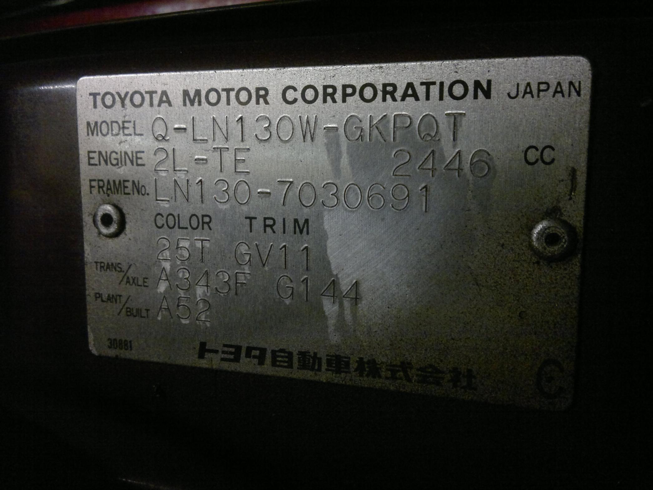

sorry i didn't get back to you, had an emergency and dashed off.Originally posted by Rustinho View PostYep. G144 - same as mine.
Front diff is 7.5", gear ratio 4.875:1, open diff.
Rear is 8".
