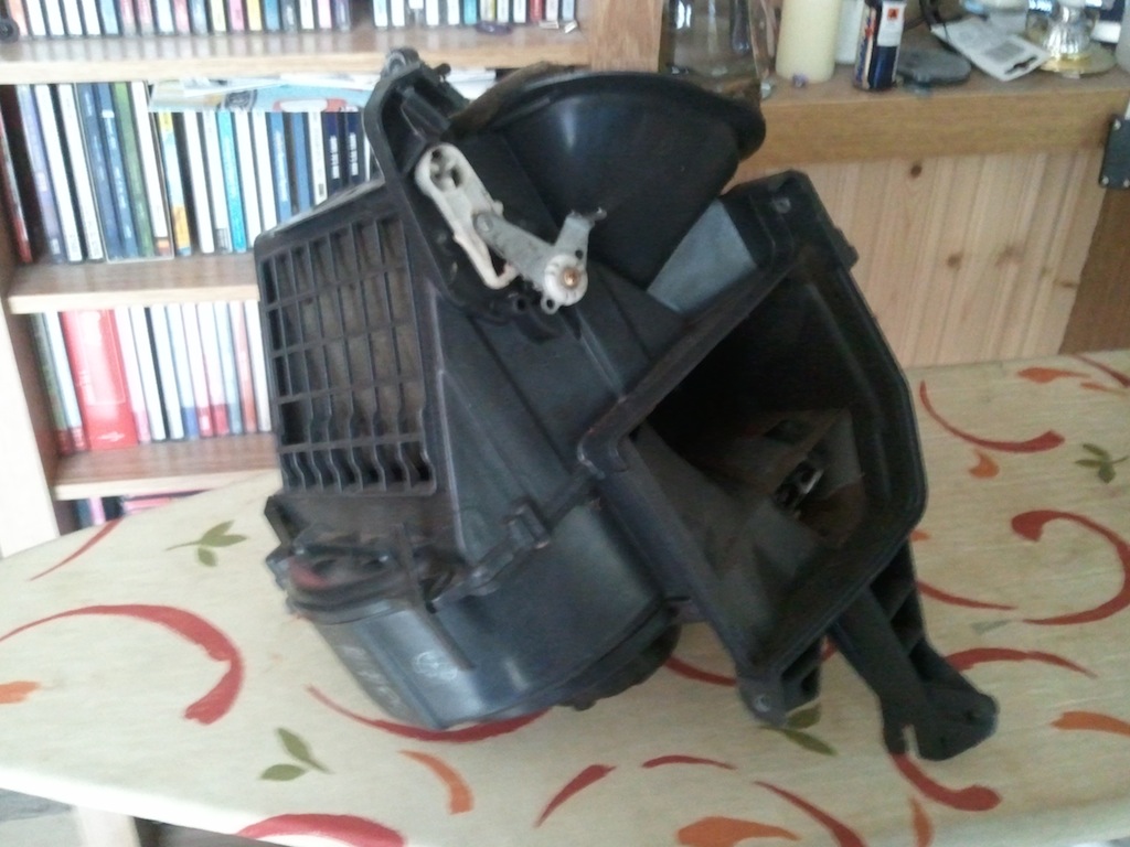

    5. I would like the centre heaters to work! No air comes through them. i Have what appears to be an air con unit (motor looking device) lying on my garage floor that i think is part of it, but i'm sure there's a fan needed too.

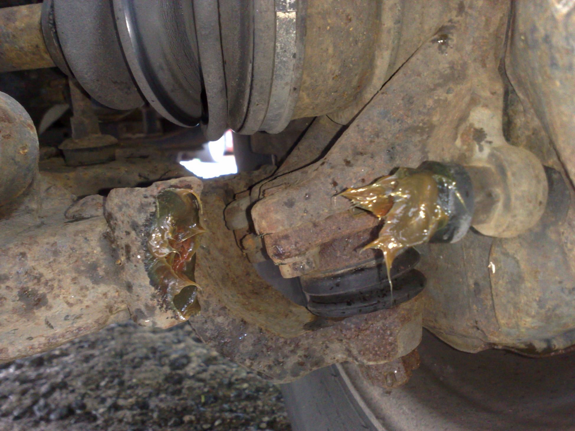

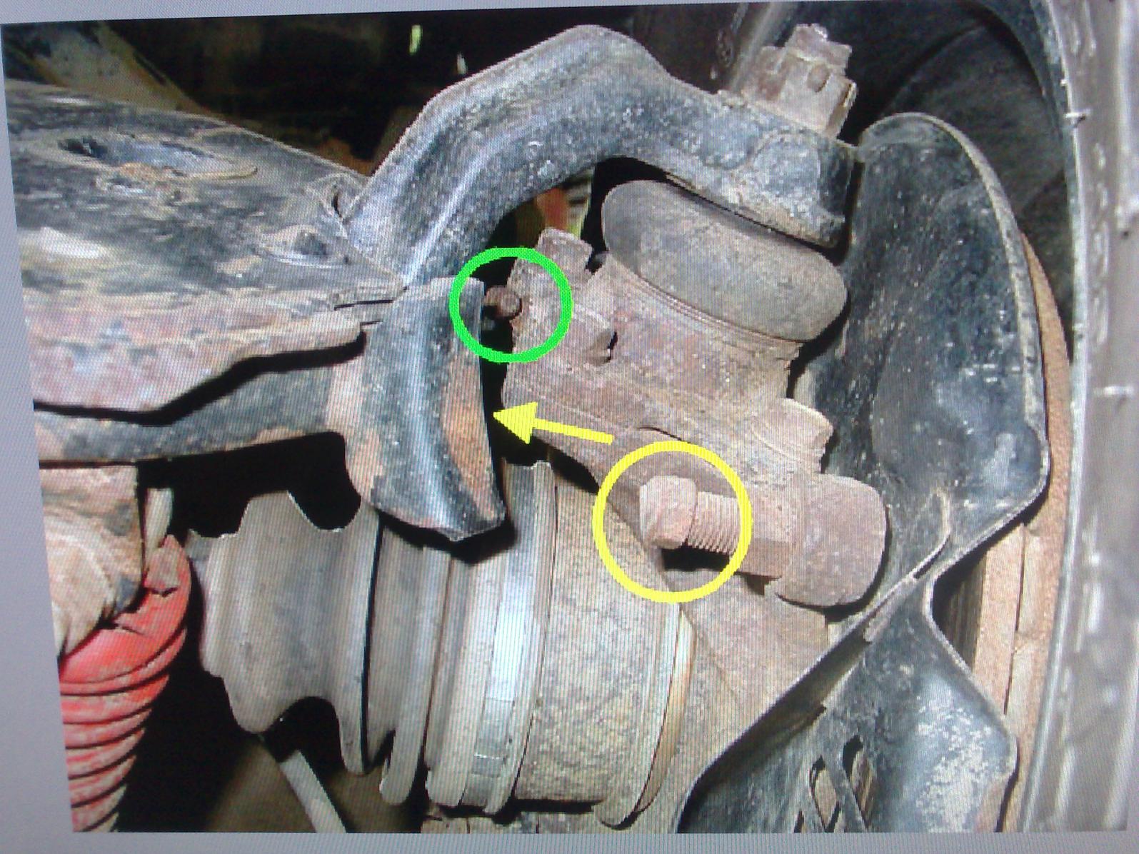

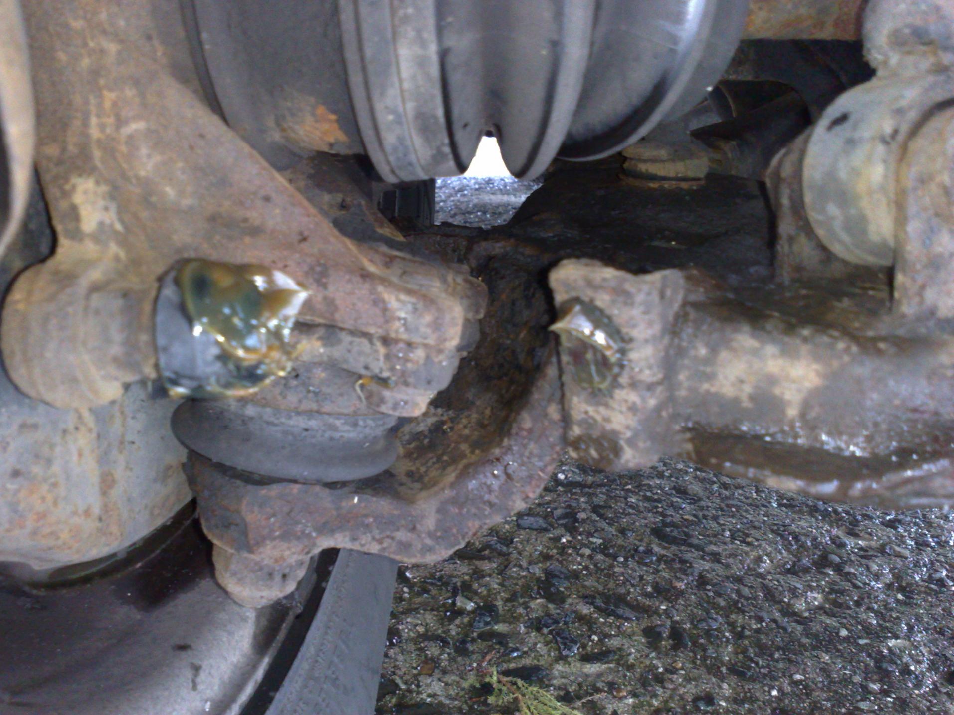

              3. If it's definitely just this area making that noise then ill just try more grease. here's my efforts from last time:
              This is what i was shown on the forum (not sure what the green circle meant)

              and here's what i did. As you can see the end caps are still there but worn through.

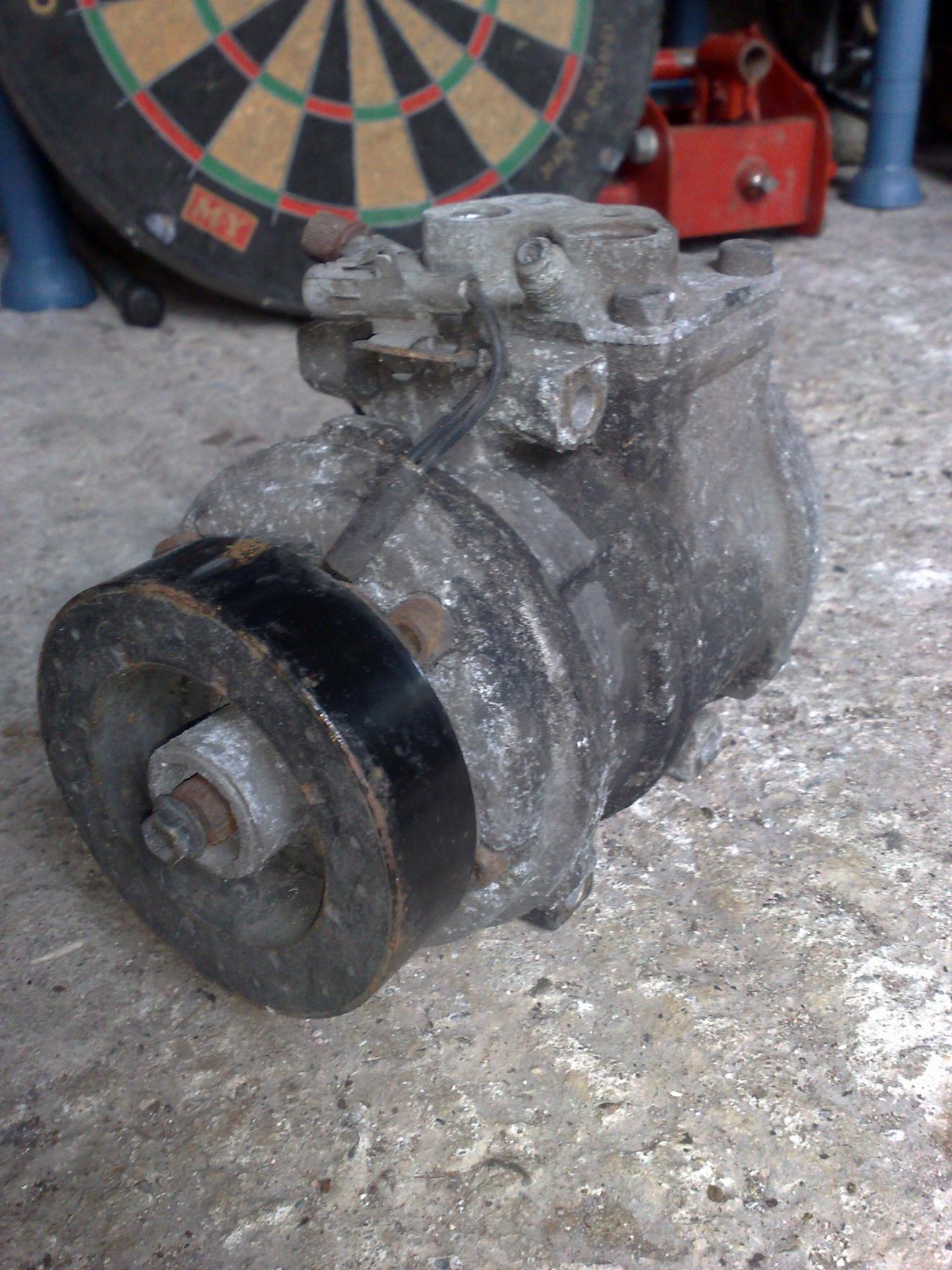

              5. Do these help? A asked for the air con unit, he gave me these. There was also some sort of mounting arm with it. i've no clue where it goes!

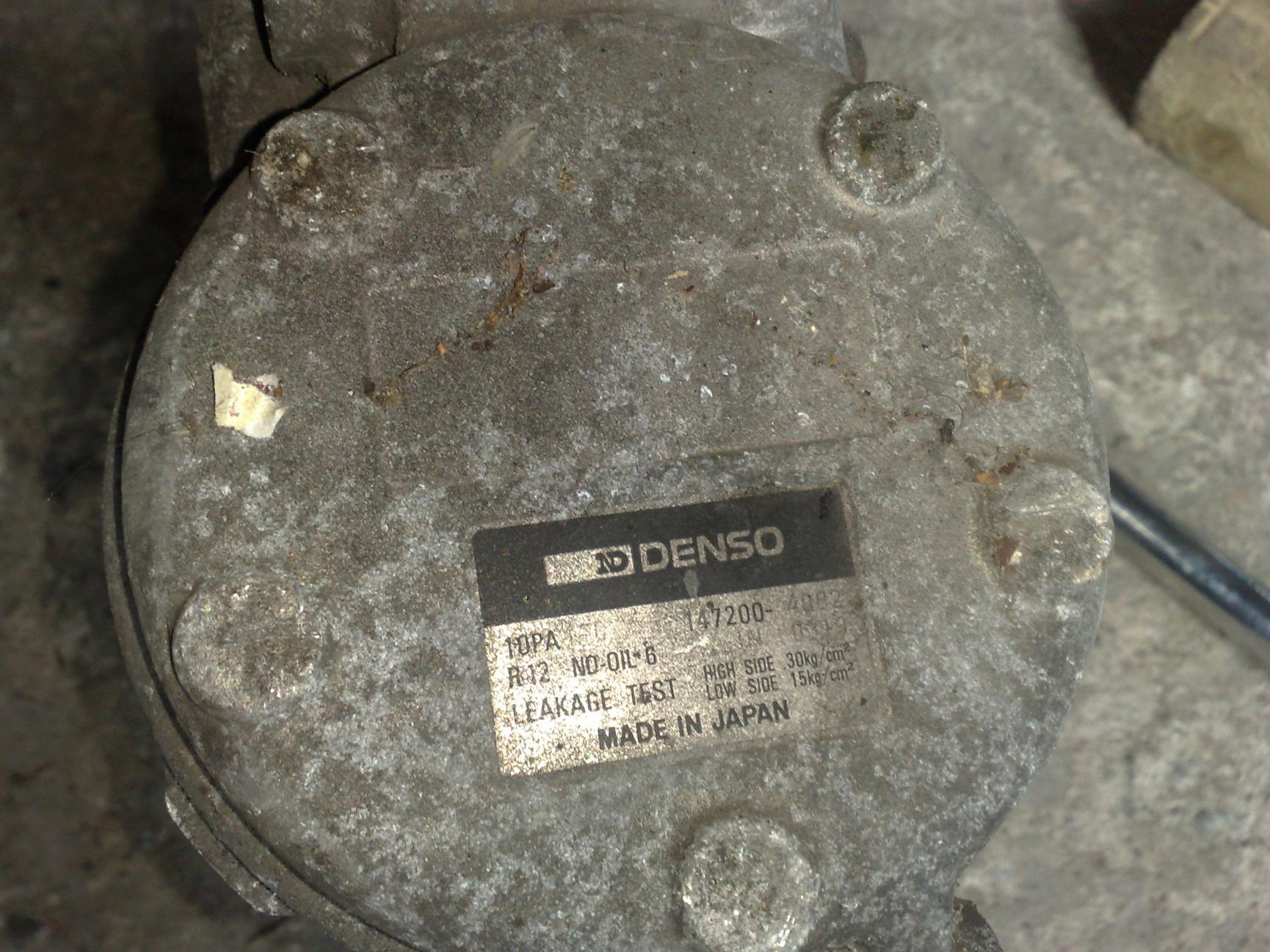

              Here's what someone on the forum offered me methinks i have some bits missing!

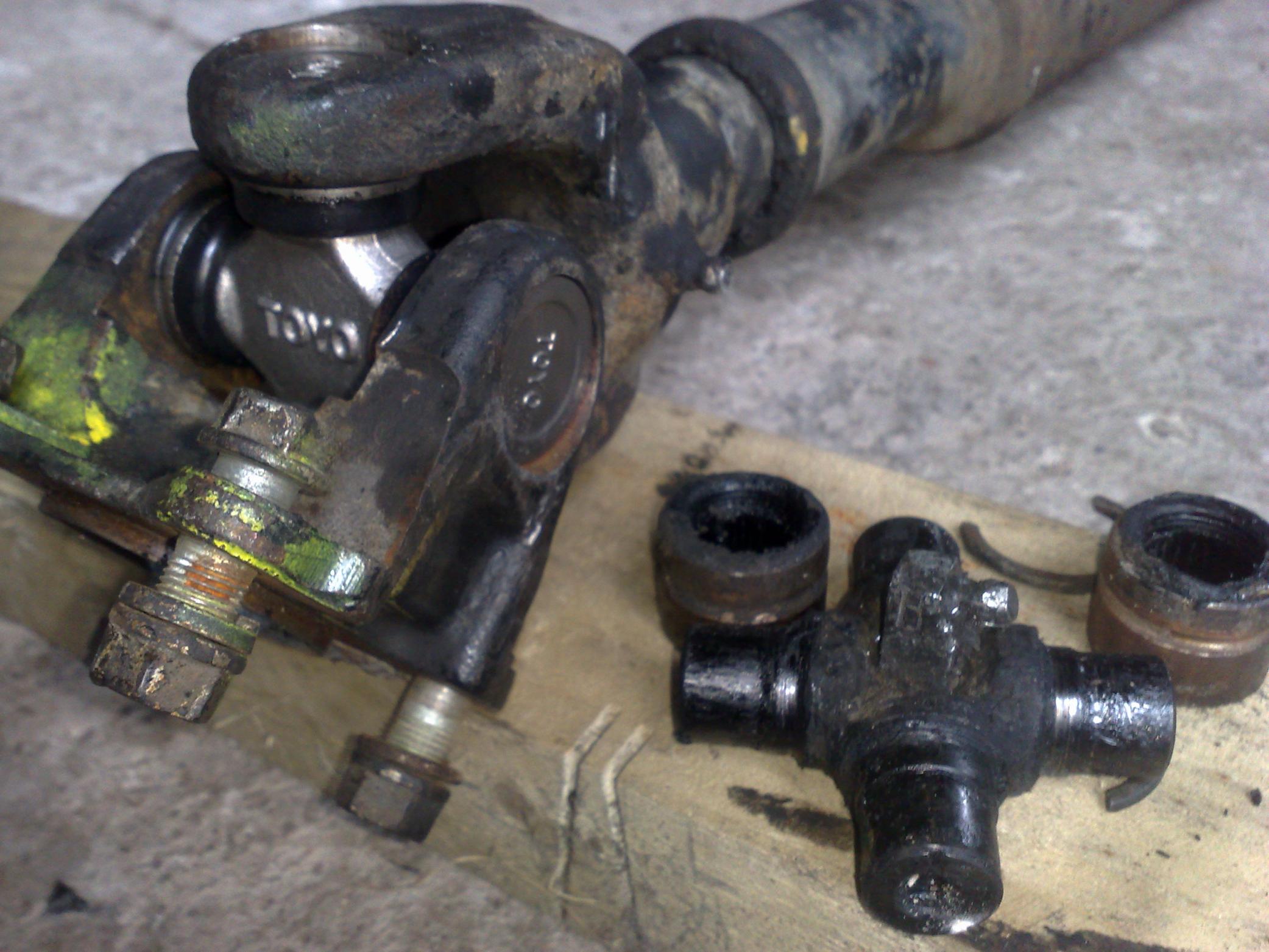

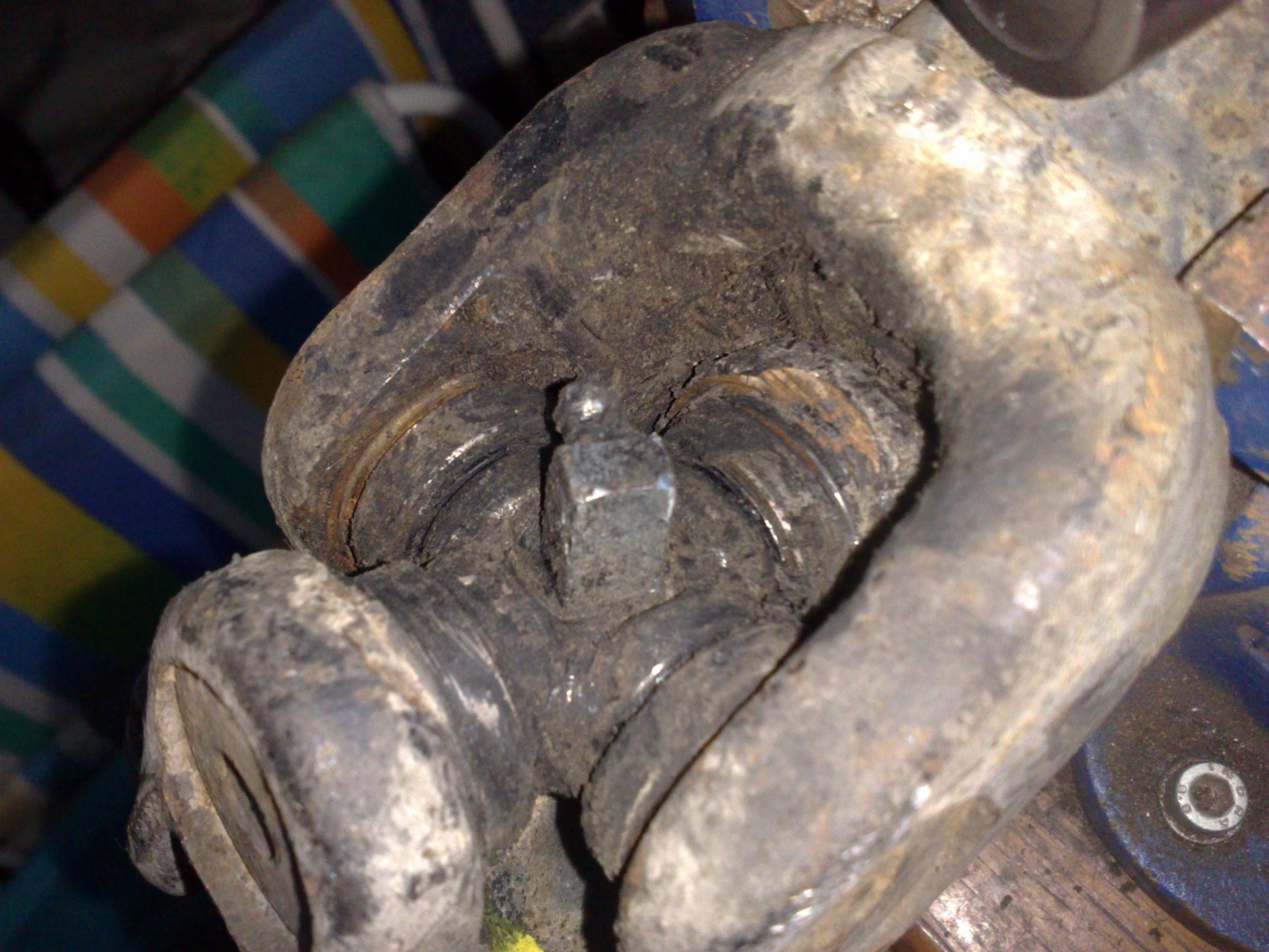

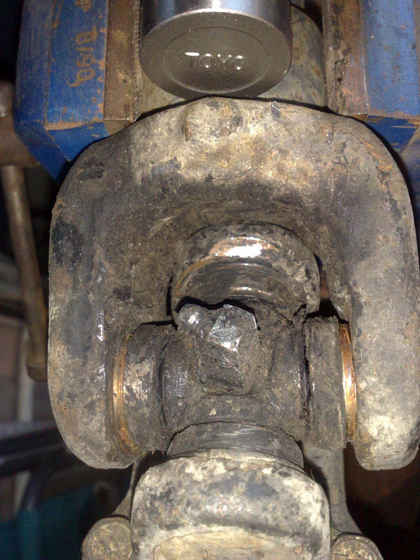

              For anyone who's interested; here's last night's saga, with a happy ending.
              Ok so here's my finished Drive Shaft with new uni joint. 5mins to fit the new one....2hrs to remove (hammer the crap out of) the old one!!!!! I had no idea that they were the end caps, they looked like part of the Flange! they were completely WELDED in place.

              So here's the fruits of my labour.
              ill put it back on the truck when my sanity has returned, along with my knuckle skin.

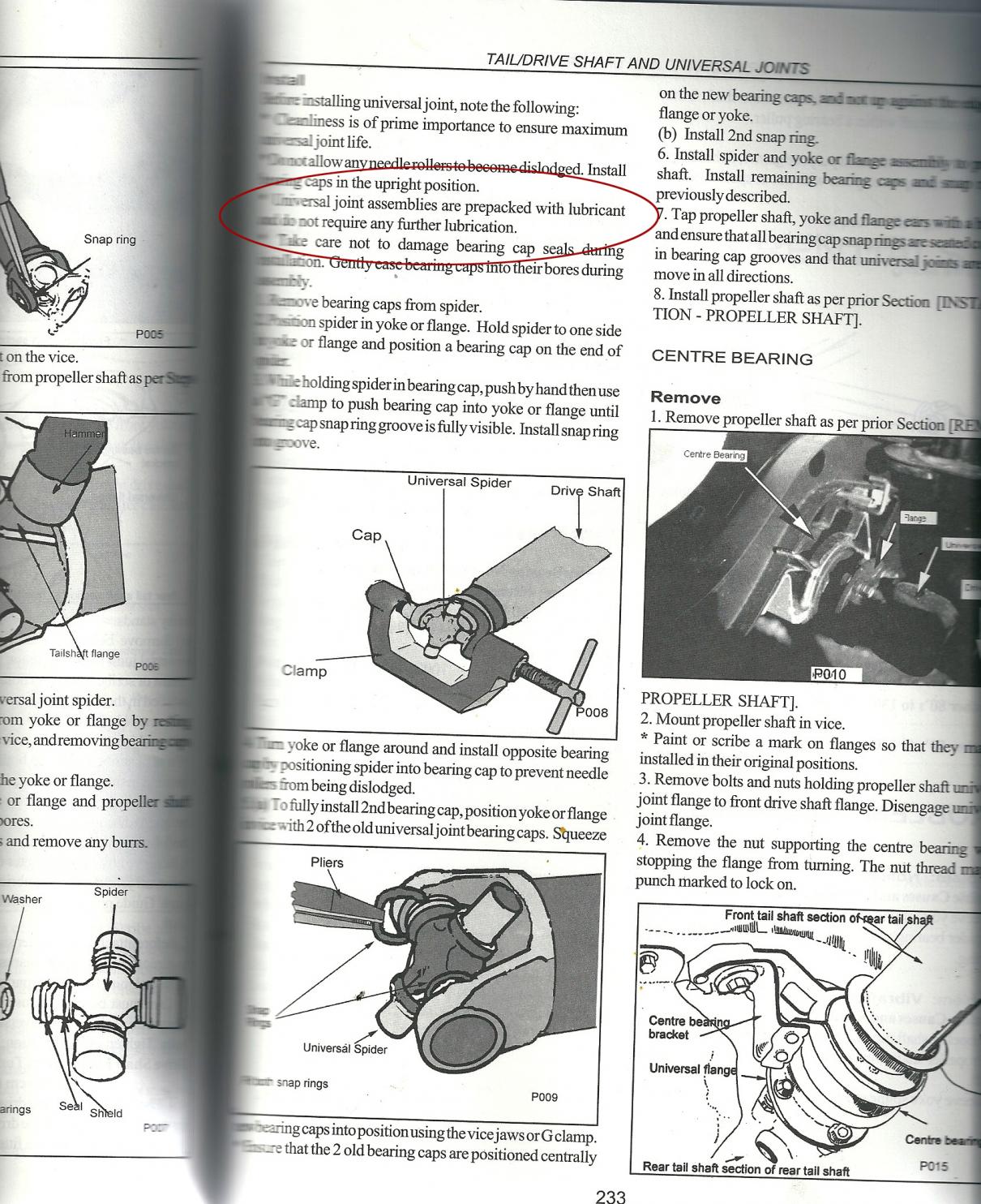

              Should grease the nipples on this newly installed marvel? the instructions in the "manual" said not to as all new ones come fully greased. hmm....can you ever over grease a joint?

                    That picture is upside down. There are 4 steering stops, one at the front and one at the back of the hubs on each side. The green circle is showing you the grease nipple on the bottom ball joint.
                    That's an air conditioning pump, but it doesn't look like a Surf one.
                    What did you ask for?
                    Either you misread the manual, or your manual is telling you shite.
                    Yes, you have to grease it.

                      Aye i know the image was upside down, that's how i got it on the forum, i just flipped it when i needed it. Didn't realise there were ones on the back too, just went out there and greased them too and.... NO NOISE ANYMORE!!!! fantastic, cheers pal. Still can't seem to find this grease nipple in the green circle though...
                      Ah ok, it looked more like an alternator to me, it was handed to me by the fella who sold it to me and he was handed it by the fella who sold it to him. perhaps it was something more symbolic, "this car was handed down to me from my father and his father before that, for generations, here take the holy alternator as a symbol of motivation, to remind you of the legacy being passed on to you."...or something like that. It did come from Ireland, you know how relics are and all that there. Or perhaps its like when you give someone a knife you're supposed to give a penny with it as a custom. It's larger than a knife and alternators are like the next step up...anyhoo!
                      Yeah i was asking the guy on the forum why no air came out of my central vents in the cockpit and i was told its coz they work on a pump and fan system, he then offered me this part in the photo. Which looked more like a contraption that went under the dash than in the engine bay.
                      As far as misreading the manual on the uni joint greasing, you tell me....
                      Page 230-> works on drive shaft maintenance and on 233 here's that little corker.
Name:	Scan 112050000.jpg
                      It's not like the Heinous Book of Lies (Haynes) we're talking about its the Aussie manual that i've also come to know and hate. =)
                      So short answer here; grease the nipple on the uni joint and on the drive shaft yoke sleeve? (about 4inches away from the joint).

                        to take the increased "angle" out of the driveshafts you can either fit 2" front diff spacers, these drop the back of the diff which pivots at the front and decreases to drive-shaft angle or as i did fit free wheeling hubs on the front, click em to X2 for normal driveing and and X4 if your going off road, means jumping out the truck everytime so whichever way you do depends how much off roading you do,
                        LC springs on the back will give ya about 3" of lift, regarding the brakes i just spaced off the rear load compensator unit to take the "tightness" off the break hose, new plus 2" shocks all round and you'll get 33"'s on ok
                        i have some pics of the verious bit's if there any help, let me know,
                        good luck with your "project"
