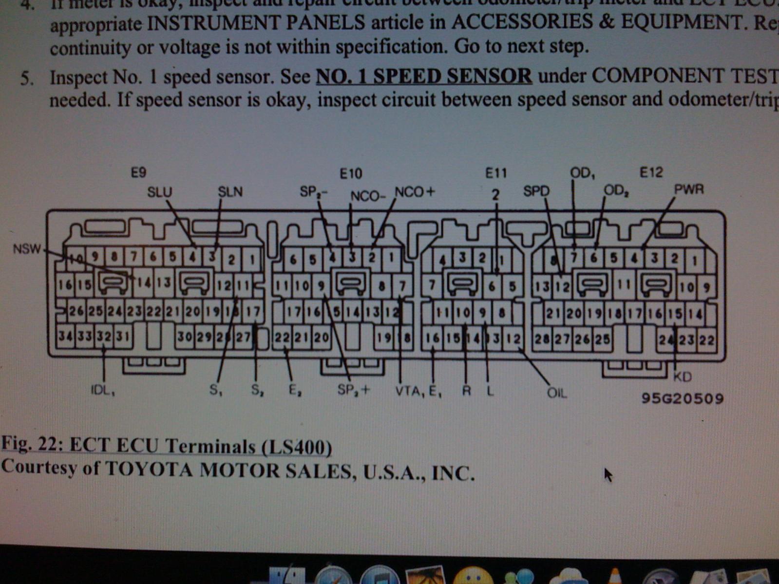

found the correct ecu pin out diagram for lexurf V - ill connect the digital speed sensor output to pin 12 tomorrow and let you know if it works
should give me 2 speed sensors like the original lexus set up
