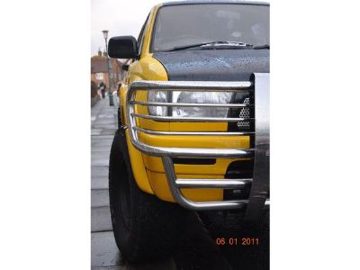

      Hmmmm, I may be wrong but I don't think so. There must be a way around it, as you can see in this picture, someone managed it!
        i`ve seen that, been pondering on it myself since i traveled halfway across the country to buy a bullbar described as third gen by someone who knew nothing.
        got it anyway. It was only £31. now i`ve just got to solve the same problem as you`ve got

            I also found another picture of a 3rd gen with what looks like 2nd gen bars fitted, (same as mine by the looks of them). I think it's that 'Bumble Bee' truck that crops up for sale every 3 months or so!
