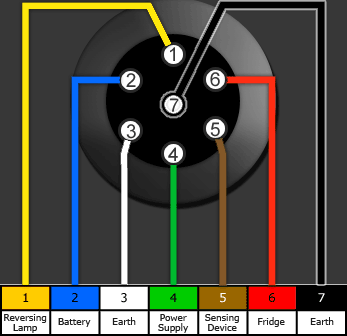

    I have twin electrics set up on my Surf. Ok,ones for trailer lights. Is the second one for caravan electrics,does that mean it has a feed to charge an Aux battery?
    Was thinking of adding a small battery to rear of truck just for running aux 12volt things,maybe a night heater as well. Thinking i could just take a feed to battery off the socket?

              1st pic = Black socket on towbar.
              2nd pic = Grey socket on towbar.
              3rd pic = How to wire a split charge relay.
                There seems to be a few power options,but i take it the battery one would be all i need.(No.2) and the earth to the negative (No.3). Or just earth to chassis?
                  Cheers.
                  Correct. No. 2 (Blue wire) goes to the caravan battery to charge it when the truck's engine is running.
