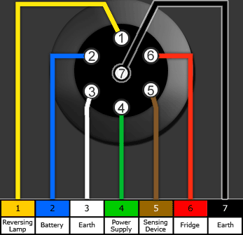

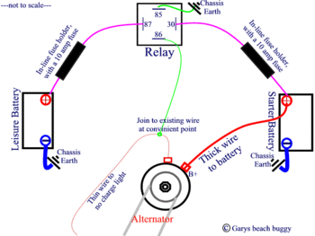

I have twin electrics set up on my Surf. Ok,ones for trailer lights. Is the second one for caravan electrics,does that mean it has a feed to charge an Aux battery?
Was thinking of adding a small battery to rear of truck just for running aux 12volt things,maybe a night heater as well. Thinking i could just take a feed to battery off the socket?
